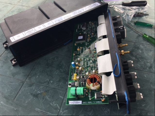

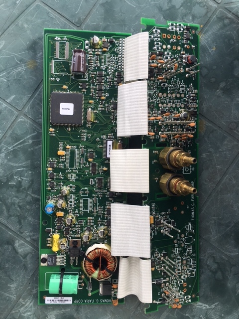

                Thought I would add this in this thread....I had similar issues over the past couple of seasons...started in 2014. No failures in 2015...total gauge failure this summer...
                Okay folks, here is my update.
                Took the gateway apart. Very easy to do. Found no corrosion or evidence of water.
                Put it back together and sealed with marine silicone.
                Used a Electronics contact cleaner on all connections.
                Happy to say all gauges are back working. Ran the boat about 4 hours over the past week...all okay...

                  Northofnine- Nice!! That's awesome and you're lucky. Are you planning on disconnecting the speedo tubes?
                  I can say the inside of my gateway box DID NOT look like that...corrosion everywhere. Clearly it had been a problem for a while before everything died. I'm hoping to get to the gauge replacement project this weekend.
