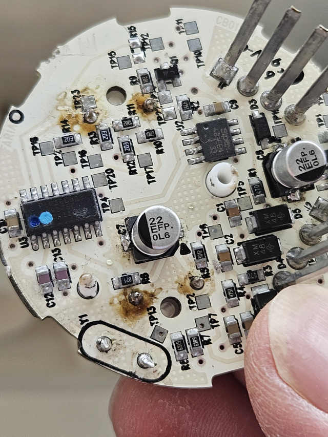

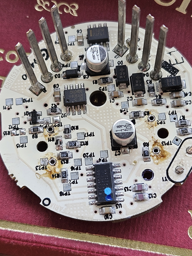

I had the same issue with 3 of 4 gauges 2" were dead.
onöy flickering and the needle ticks slightley.
I figured out, that de smd 22uf 10V Elkos were the Problem on my gauges.
first i replaced e times the steppermotor.
no change.
Then i went on the capacitors.
Cause they dry out by time,
orderd some 22uf 25v smd aluminum capacitors.
and replaced them.
Result Led's light up again and the needle (steppermotor) started working again
I guess the elkos csuses the failure on thr gauges.
if the gateway is working properly of course.
Little tricky to do the smd soldering.But works with thin 0.5mm zinn wire.
and with e small poimt soldertip.
The old caps. I cutted them of with a cutter tweezer, so i could de solder the conectors.
then placed the new ones.

new Elkos
Old elkos
