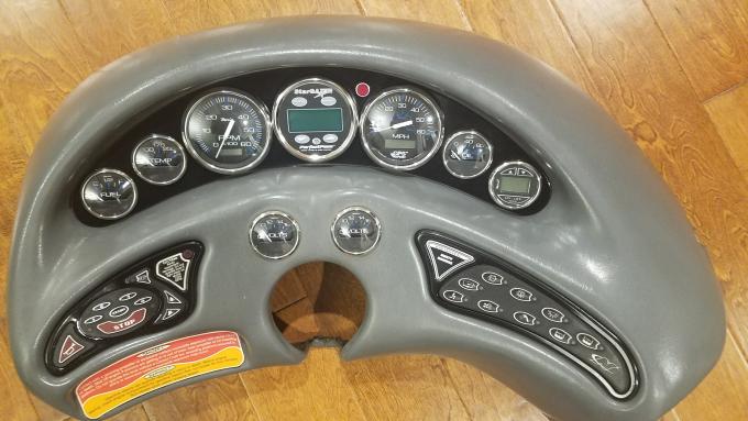

        This is what I did... all new Faria Chesapeake gauges. GPS speedo eliminated the pitot tubes completely. Stargazer PP matches perfect. No regrets!

                            I finally got time to install my gauge kit from nautique parts this past week. Installation was a lot easier than i expected and after an hour on the water everything seem to work except for my speedometer. It still hasn't acquired satellite signal. I mounted it per the instructions. Has anyone had similar issues or what time frame should it take to acquire satellite signal?
