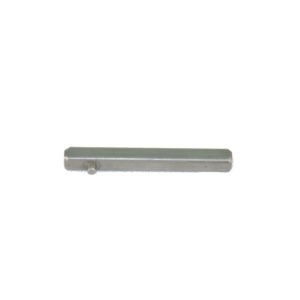

    I still think the key with the stem on it may play a role in weakening the shaft, but nobody commented last time I suggested it might be an issue. It seems to break right where the extra hole is.
    Click image for larger version Name:	propeller shaft key.jpg Views:	1 Size:	3.4 KB ID:	569610
    You could very well be correct. Given the frequency of the breaks it seems that the engineering safety factor built into the design of the size of the shaft is too close. If the pin in the shaft is enough to cause a failure then the shaft is too small in diameter. Too tight a margin, an out of alignment shaft or strut an imperfectly balance prop etc. None of these have to be obvious to the operator but maybe just a subtle alignment problem is enough to snap the shaft.
