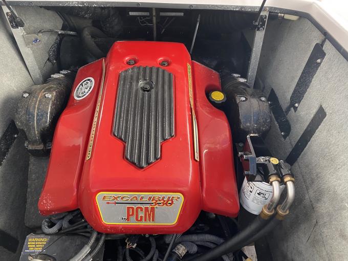

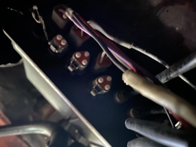

                    I have a 2005 226 that I just pulled out of winter storage. There appears to now be an issue with the engine data connection to my gateway box. The tach doesn’t work (works on PP), engine hours are showing zero, no egt, etc. any idea where to check for the engine data connection?
                    • fsts2k
                      • Nov 2004
                      • 218
                      #160
                      One other note.. what is frustrating is that I paid for shrink wrap storage this past winter. It is clear they left the boat outside before wrapping it and water got in it. In addition to the lack of gauges now, the Amp (I just fixed this last year) is throwing a fault. I am pretty certain the water in the boat was then contained in the shrink wrap all winter and the high humidity creating corrosion. Before I pull the gateway box and started to look inside (per the instructions posted to the site) I was going to first start with cleaning the electrical connections.
                      I have found the PCM manual and identified the Engine Harness (round plug) which would appear to be providing the information to the gateway box but I am struggling to identify where that is on the engine. Does anyone know if this is under the red engine cover? Trying to avoid tearing too much apart.
                      The voltage gauge and the speedo both work so I was thinking the gateway box is ok.
                      Thank you for any assistance.

                        The fact that the voltage gauge works is actually a good sign if your boat is like mine. The voltage gauge is the last of the 4 small gauges to the right? That means that the serial bus is OK and likely the gateway too. In terms of the other 3 small gauges (Oil, Fuel, and Temp) it's very likely the gauges have gone bad, especially if you have not replaced them (17 years). Does the data in the Tach multifunction display look right? Can you see Oil, Fuel, and Temp there? If so, then my bet is the gauges. See my post above.

                          Actually there is no data in the multifunction display which is what made me think it is the connection from the engine ECU to the Gateway. I was going to take that connection off, clean it, and see if that helps. Any other ideas?

                            Hmmm. Even the fuel information (hours left) is dead? I'm pretty sure the fuel information (like the voltage level) does not come from the Engine ECU but I'm honestly not sure how everything is wired. If you're getting NO information on the MFD then I would suspect the gateway, possible just connections. I would also pull off, clean and reseat all the connectors to the gateway. I assume your Faria Gateway is under the dash mounted to a bulkhead like mine. I actually had one connector on the gateway (Perfect Pass) with the wrong keying from the factory. They just forced the connectors together and shipped it. Lasted about 10 years that way before I discovered it. So.....make sure all those connectors are fully seated and the keying "ears" match correctly.

                              My boat doesn't actually have hours left on fuel, it is only a fuel gauge (which has intermittently worked for the past 7 years) but otherwise, yes, no engine information. Have electrical cleaner, soft brush, and some gumption to pull all connections, clean, and replug in.
                              The Gateway is actually on the rear transom behind the engine. The 226 was not exactly designed for maintenance I have learned

                                Trust me, the SV211 is no better. The gateway is behind a fuse box panel that has to be pulled down to access. Your back will hurt when you're done.
                                But the gauges are easy to access, 4 screws and the dash pad comes up and easy access to the gauges.
                                I still contend that if the Voltage gauge works and the Fuel gauge doesn't, my guess is the gauge itself.....
