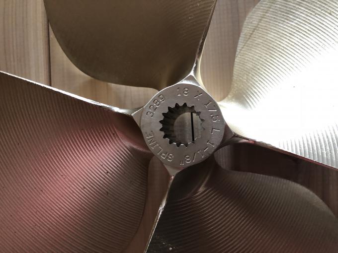

shafts on my G had an obvious machined surface, whereas on an MC, it isn’t." as if this somehow indicates it is

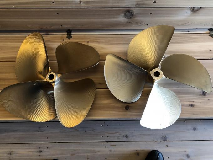

forged. All shafts are machined at the prop end. Mastercraft uses a Splined shaft. By definition it is machined. 2) I don't know what measurements you have seen to state that the G is the most bow down boat ever built. All surf boats have a plate at the stern of the boat that can be used to rise the bow to create greater pressure at the stern resulting in a steeper wave with more push. This is the setting most frequently used to SURF. Skim boarders might prefer to lower the bow by lowering the plate to push the bow down. This reduces the pressure at the stern resulting in a longer and less steep wave. Every surf boat can raise or lower the bow based upon riding preference. Granted the G does have a lower gunwale in the bow. This is to improve driver visibility when in a bow high configuration. The down side of this design is that one can take on water over the bow when the ballast is full if you hit a large wave. Perhaps better visibility is attributed with a more bow down boat? But that is perception, not the angle of the hull to the water. Finally, the bow high attitude is ONE factor contributing to the failure. This factor combined with the 2:1 transmission, 17" prop, and fully loaded ballast at surf speeds ALL contribute to increase shaft loading. Many boats can have larger props, but not larger props with all of the other characteristics in a large enough sample size to experience the shaft shearing that has occurred. I believe we are talking about tens of shafts sheared in several thousand boats.
3). Stock prop on what? If you look at https://www.ozpropellers.com.au/mast...at-propellers/ The only Mastercrafts with 2:1 Gear ratios are the X20, X23. Both of these boats use the 16.0 or 16.5" props. Many boats use larger propellers than 17". But they don't have a 2:1 transmission, and push heavy surf loads too. I'm not defending this design, just identifying the factors that cause the failure.
