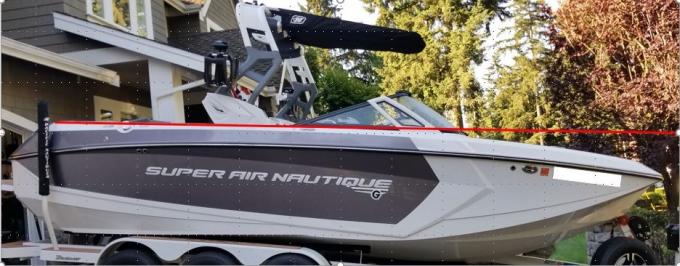

For those of you who say the G23 is a "bow down boat" therefore prop angle is not a factor loading the shaft... Consider this photo. The gunwale of the G23 lowers from the windshield forward. This is a design goal to improve driver visibility. Most people see this as the G23 being a "bow down" boat, because the person thinks "look how well I can see in this boat"! When I drive boat xyz I have to sit up higher. Also if you believe a level boat can make a great surf wave, then you really need to take a physics class. The hull MUST push water to make a large wave. To do this it has to push the stern down into the water and move a mass of water to the side. Without this there is no wave. It is NOT possible to make a great surf wave with a level boat.
Also this is not caused by ONE factor. It is a multitude of factors: The asymmetric prop load during surfing, pushing large amounts of water AND exacerbated by a surf system which causes the boat to YAW, not ROLL or List (like MasterCraft or Centurion), AND a 2:1 transmission increasing shaft torque, AND the 17" prop load.

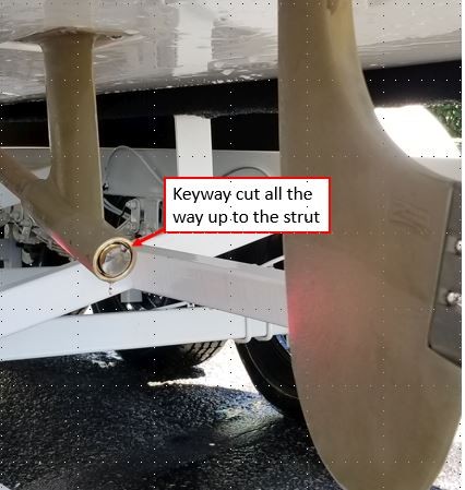

I'm beginning to believe this failure is fundamentally due to the keyway cut into the prop shaft. My previous shaft had a longer keyway cut into the shaft that extended almost back to the strut. With an asymmetric load caused by the angle of attack of the lower prop blades the keyway could be the origin of the failure. Looking at the shaft that failed below one can see the keyway cut into the section that still remains just in front of the strut. This would be the point of greatest load on the shaft from the asymmetric prop thrust.
And here is the new shaft. There is no keyway cut longer than the 3" prop hub, e.g. This prop is a 17x17 3" hub, not a 3.4" hub. The extra room is for the longer hub props.
