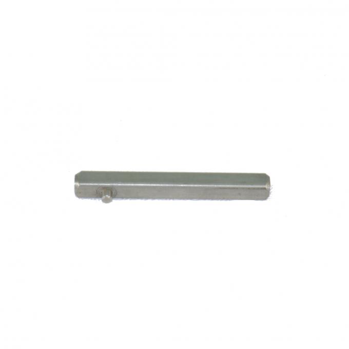

    Interesting point about no failures on the same boat twice. Also someone else observed that it seems if you get beyond 100 hours, your risk of shaft breaking goes way down.
    Is Nautique the only boat mfg to use the key with a dimple? They have done this since 1997, but I wonder if this weakens the shaft to the point a 17 inch prop can then break it. Until I picked up a spare today, I had never seen one with that dimple (I've not yet swapped my own prop out).

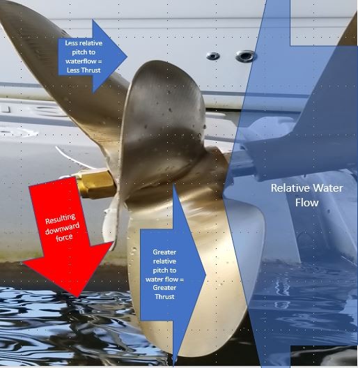

    I see no reason to debate this here, the point is that there is a cyclic load on the propeller caused by differential thrust, I believe we can agree on that.

    It’s actually the left and right sides of the propeller that have the larger effect and I maintain boat “pitch” is a secondary issue but as we are basically discussing the same issues it doesn’t really matter. Point is there are multiple issues here and, it seems, that only the G boats have the problem. My interest is in the ways that these boat differ from everting else out there.
    I think there is a misunderstanding. There is NO left and right force that can fatigue the shaft. Both the left and right blades experience the same relative waterflow and therefore generate the identical thrust. It is the top and bottom blades that cause the resulting downward force that causes the shaft to fatigue and fail. I have discussed this with several engineers very experienced in propulsion design. Perhaps you are thinking about prop torque. But prop torque causes the boat to roll to the opposite side of the prop rotation. This force is directly longitudinal to the shaft. It does not cause ANY asymmetric force that would fatigue the shaft.
    Here is a picture to help one understand the issue. Both boat pitch and shaft angle combine to cause the top blades to become more PARALLEL to the water flow, reducing the relative pitch and thrust of the top blades. While the bottom blades become more perpendicular to the waterflow enabling them to generate much greater thrust than the top blades.
    Click image for larger version  Name:	Relative Pitch.JPG Views:	1 Size:	64.3 KB ID:	560219
