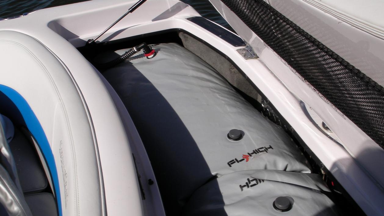

                can you post a photo of the rear sacks when full?
                I pulled the hard tanks and am finally ready to get moving on this project!

                  I'll try to remember to take some pics this weekend of the rear sacs full. With the v-drive sacs full, it leaves enough room for me to store a few things on top (a few life jackets, a rope, and my empty straight line 440lb sac I put on the rear seat for surfing). Note, the extra 440 alone is not enough to surf, I also have 400lbs of pop bags. One could use another 400lb v-drive sac instead of the pop bags.

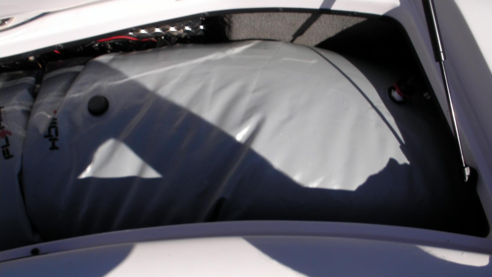

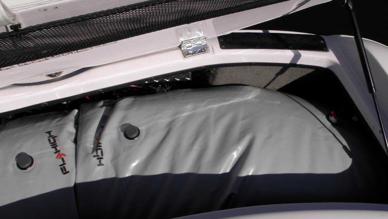

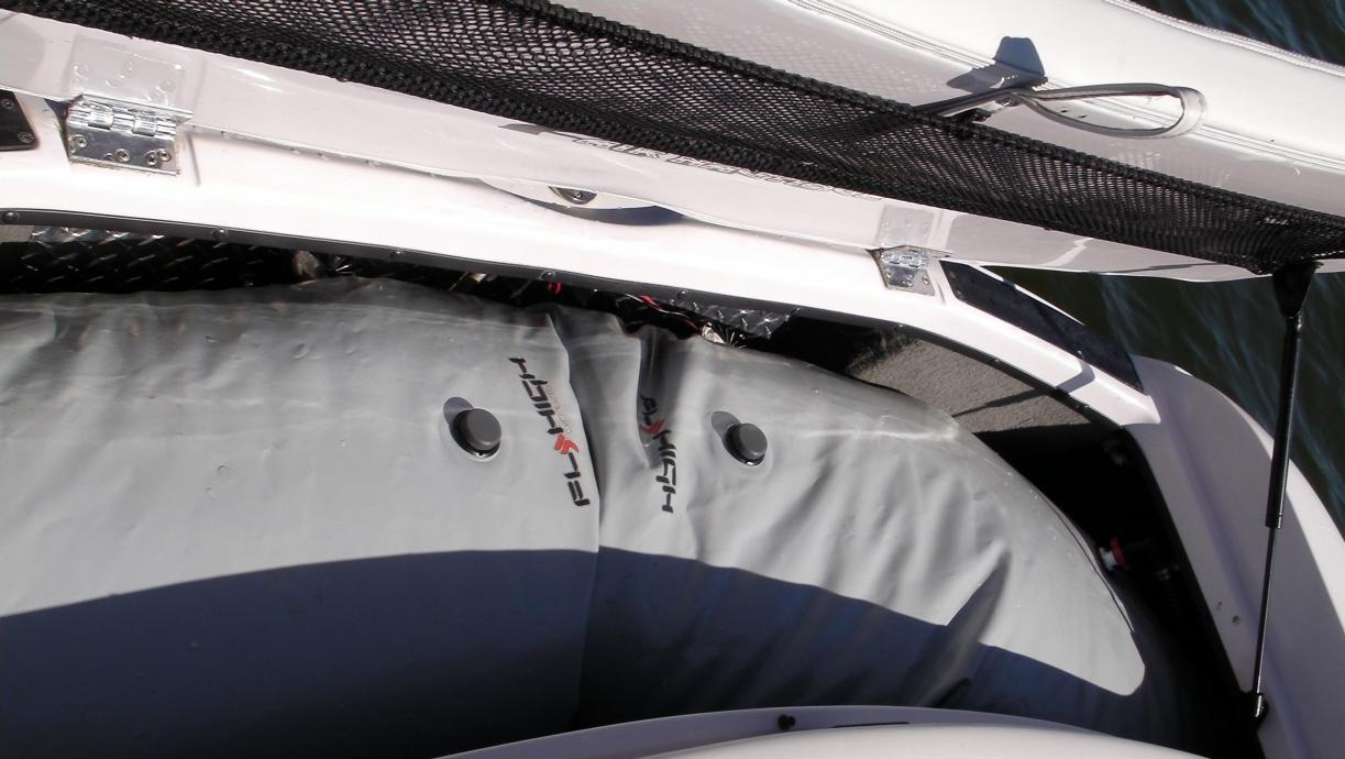

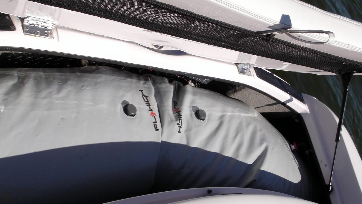

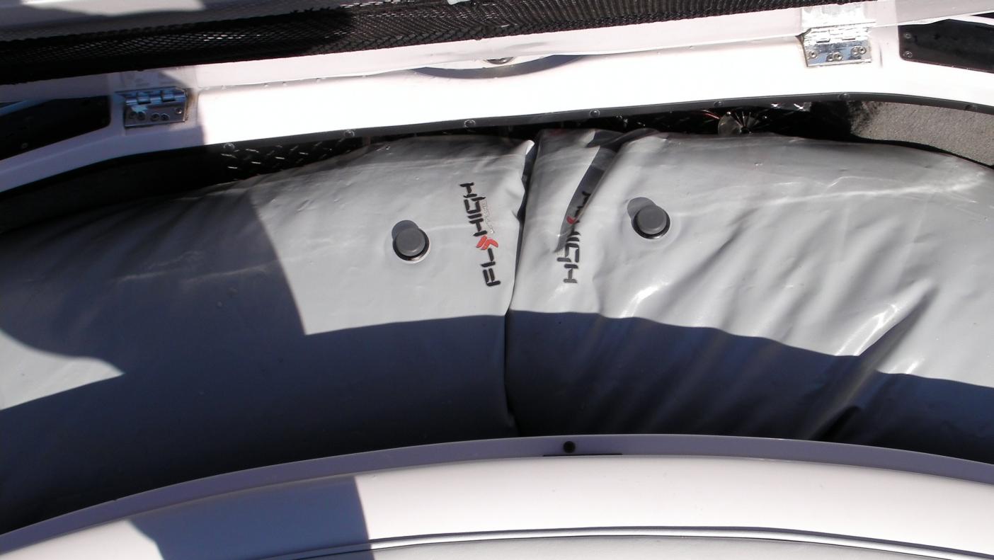

                          Ask and Ye shall receive.

                                Scott,
                                Those sacs look to be a perfect fit there, do they fill 100%?
