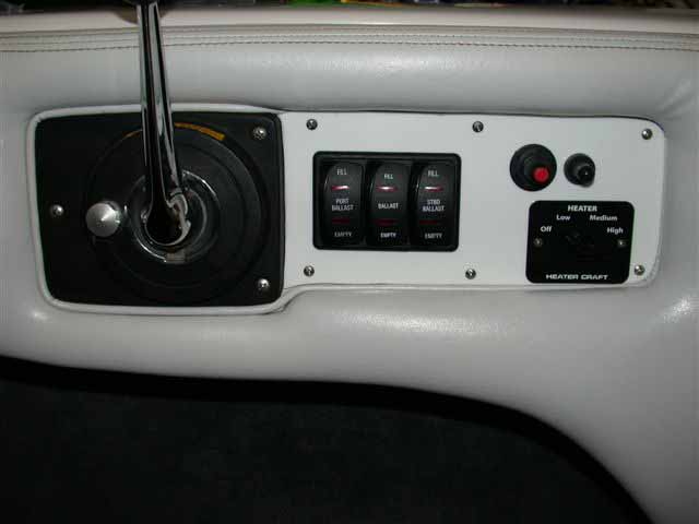

              where'd you get that mounting plate for the switches?
              • wake_fun
                • 1330
                • CA
                • 1995 Super Sport
                I ordered it from West Marine. Each section slides together and you could add as many as you want. I ordered mine as you see it, with the three sections. If you look at my ballast install part I thread there is a better picture of it not installed yet.
