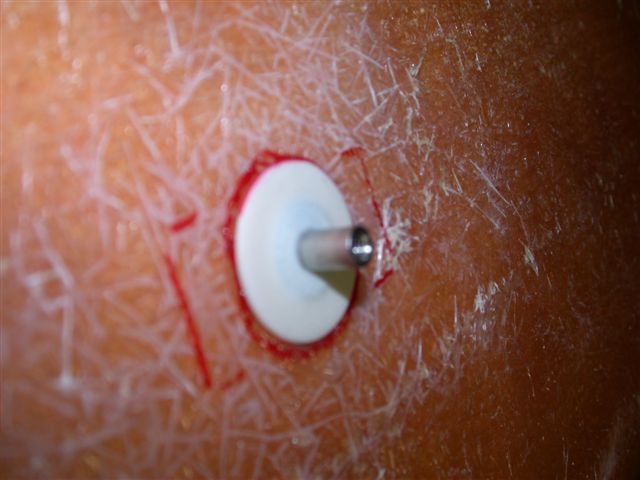

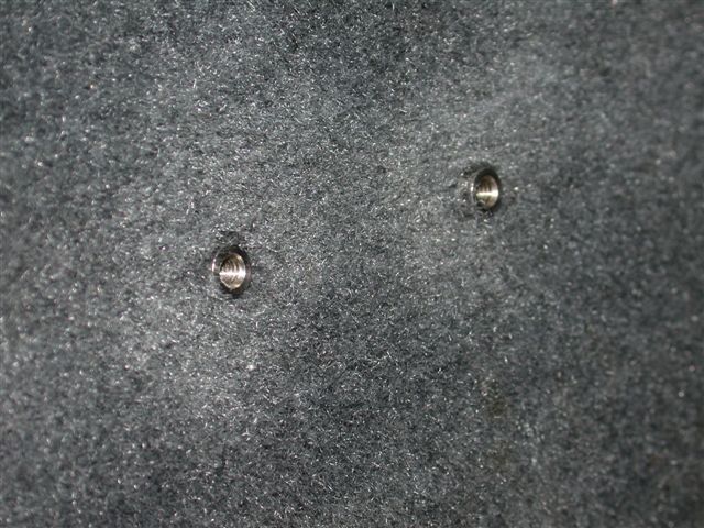

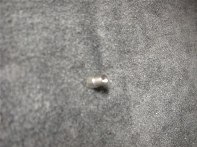

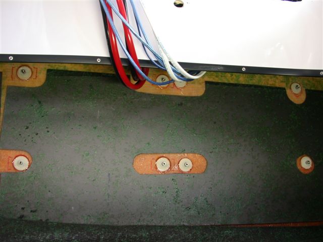

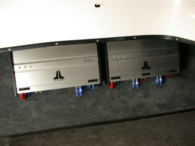

    I finally finished my stereo install. Here are the pics of the amps. I did it without using wood with glue or long metal staps bolted to the boat. All fasteners are stainless steel. I used 16 GA steel as my template for the amps.

    nice wake_fun, what are those things pushing??

      Four JL XR650-CXi's in the stock location and one JL 10W7.

        Don't know if you already have your JL 10W7 installed yet, But I have a a 2001 SAN and my 10W7 with the JL sealed enclosure fits in behind the Kick board of the drivers feet. It sounds awesome there too, I have it facing foreward and the bass just wraps up and around the bow seating. I have my amps mounted in the same place as you too. No one could ever know i have a 1600 watt system unless they hit the start button. Super stealth.

          How did you connect those nutcerts to your hull? Epoxy or are they drilled in? I LOVE the way you did thi and am thinking about doing the exact same thing to mine. My stereo kicks but the wiring and setup is crappy.

              Epoxy

                          To everyone that has asked.
                          www.clickbond.com
                          Glass/Epoxy Base, Stainless standoff

                            They have stood up to the test of many hours of boating. No failure, everything is perfect!!!!!!
