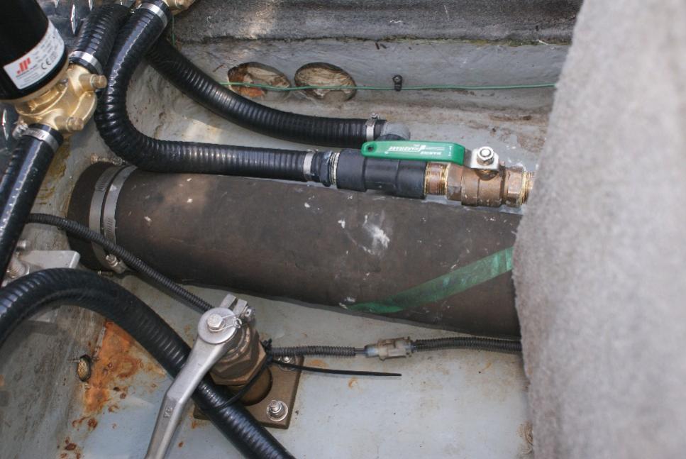

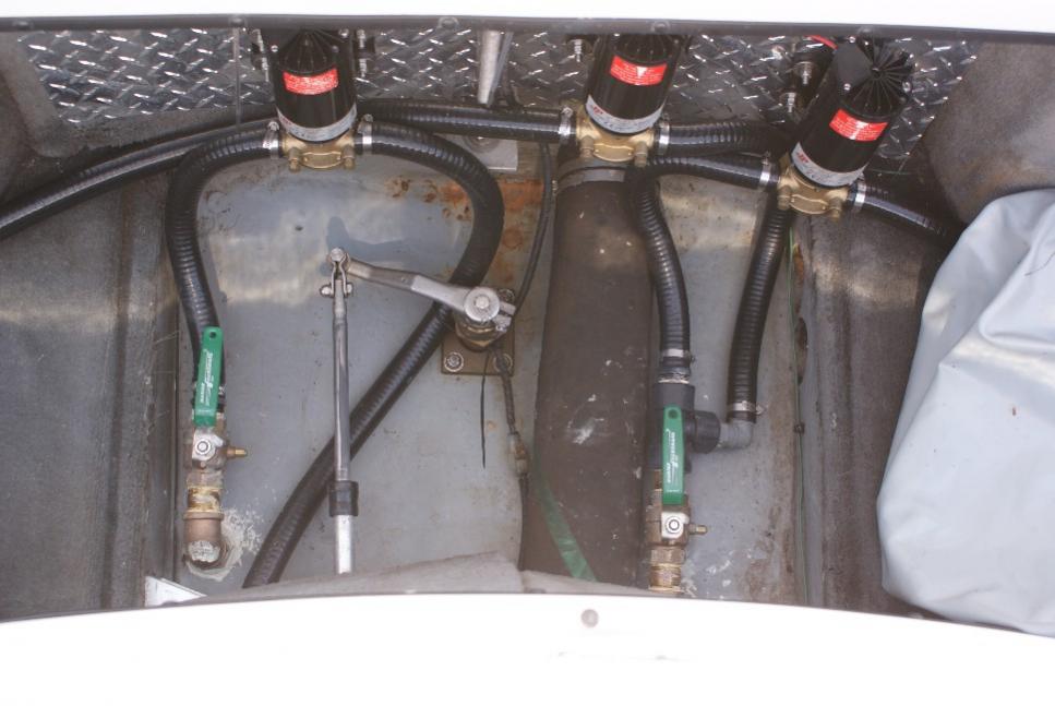

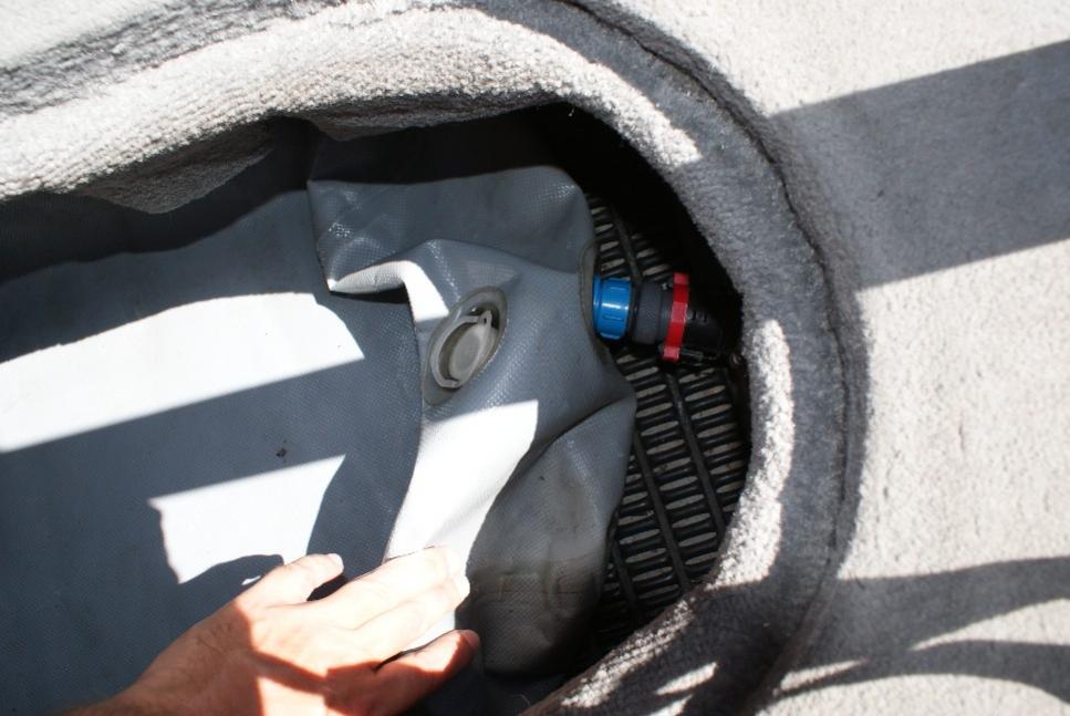

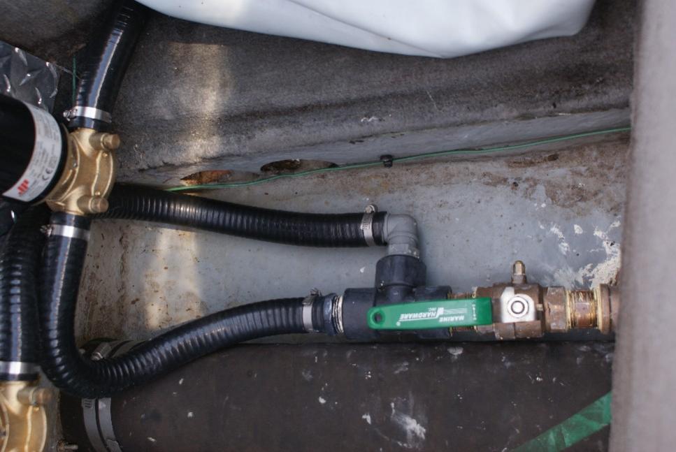

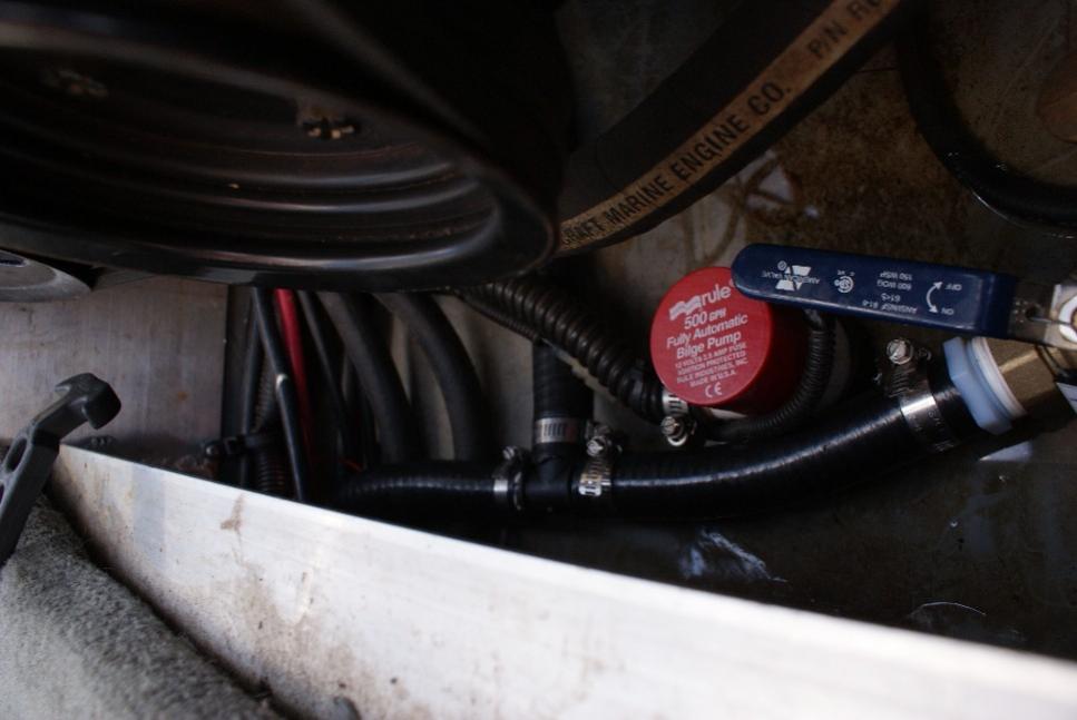

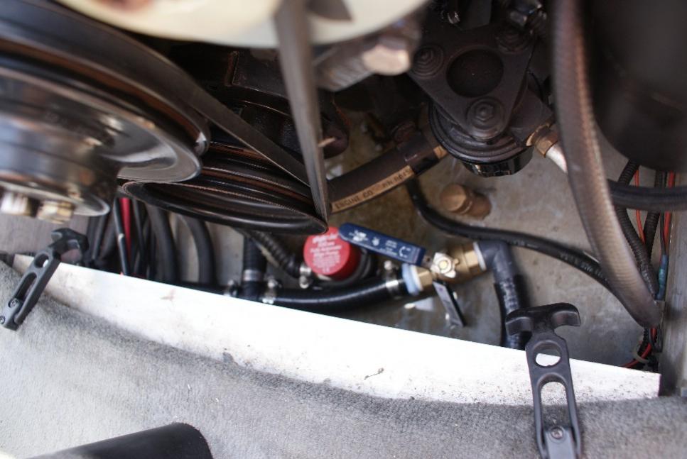

      Not sure if anyone is following this thread or cares, but I thought I would share the last part of my ballast project in case it will help anyone now or in the future.
      For my belly and integrated bow sacs (which share a single pump), I added a hose barb "T" before the bags plus a ball valve between the "T" and the belly / ski locker sac. This allows me to adjust the flow rate to the belly sac to slow it so that it fills around the same time as the integrated bow bag. So far, it is working well. I have a vent / overfill line on my bow bag, but not on my center bag. Since it is right by the driver, I can keep my eye on it. It will also start to lift up the hatch when it starts getting really full.

              I'll try to take and post more pictures this weekend when I am down there. Adding a ball valve after the T to the ski locker sac worked like a charm. I have it open about 30% of the way, and now my integrated bow sac fills about 5 - 10 seconds before my ski locker sac, which is just what I wanted. Water starts overflowing through the vent line prompting me to check the ski locker sac, which is just about full at that point.
              My only complication now is that my rear sacs have never overflowed. I am beginning to think that the factory things I tied into either (a) are not check valves or (b) are check valves stuck in the closed position. I'll take a look this weekend.

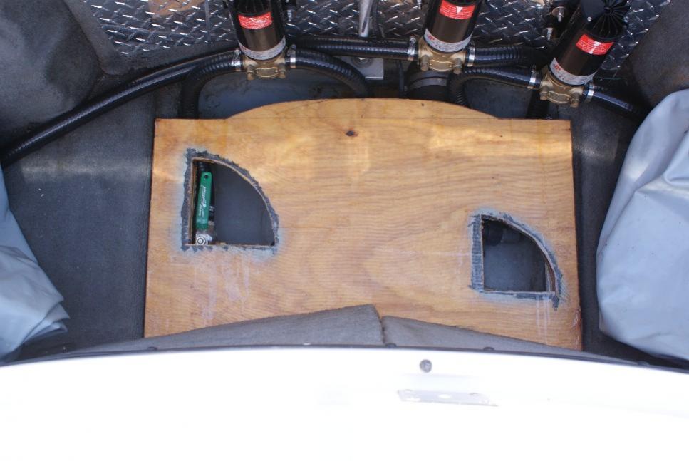

              One last thing, in case I did not mention it earlier, instead of tearing up the existing floor piece, I made a custom floor piece for the rear with cutouts for the ball valves. I made it out of 3/4" plywood and wrapped it in fiberglass and epoxy. I'd have it carpeted, but my compressor for my staple gun is 4 states away at the moment at my other house.

                Note, Johnson pumps are fast and very loud. There is no way you are not going to hear the sound change of the pumps when the bags are empty.
                Scratch that. With the rear hatch closed and the motor on, they are barely audible.

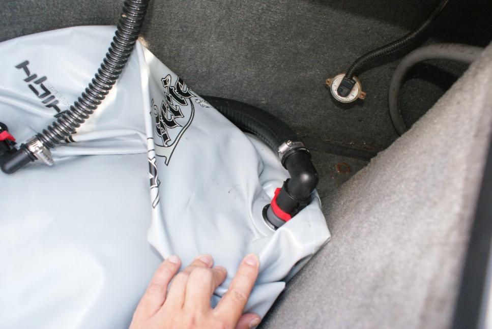

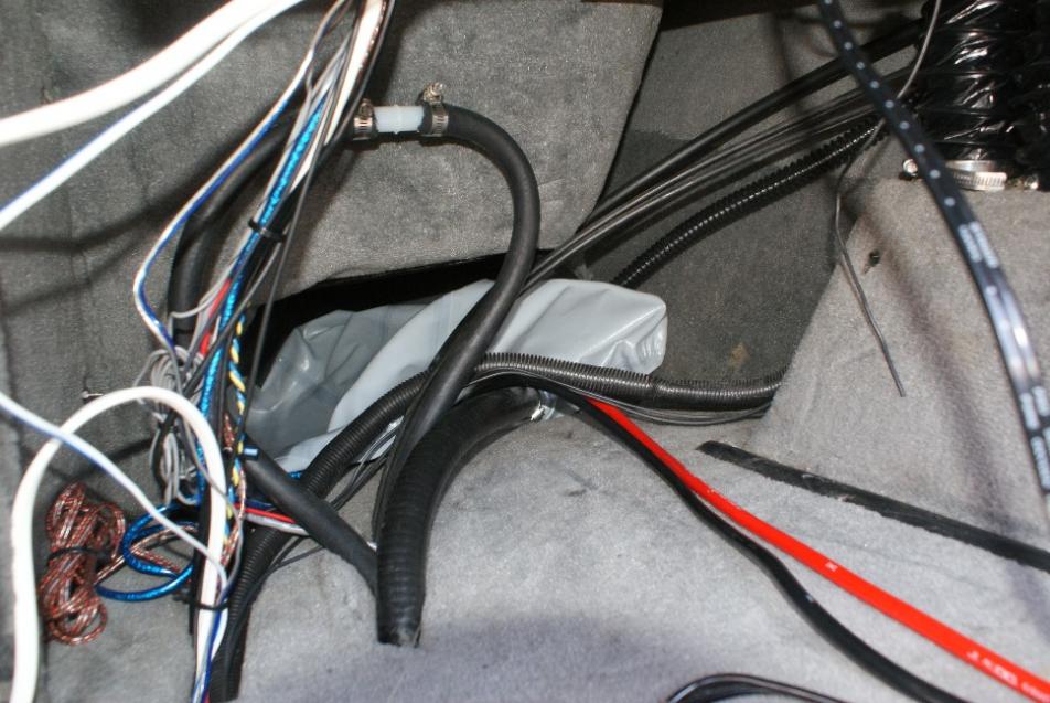

                          #27

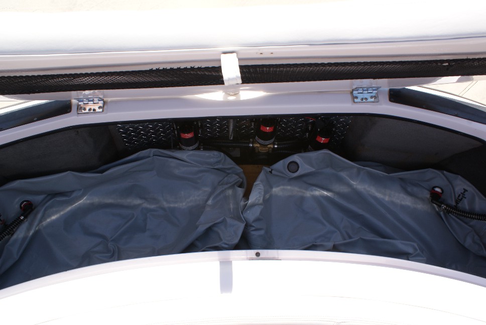

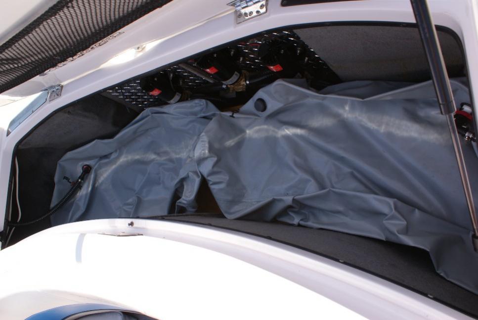

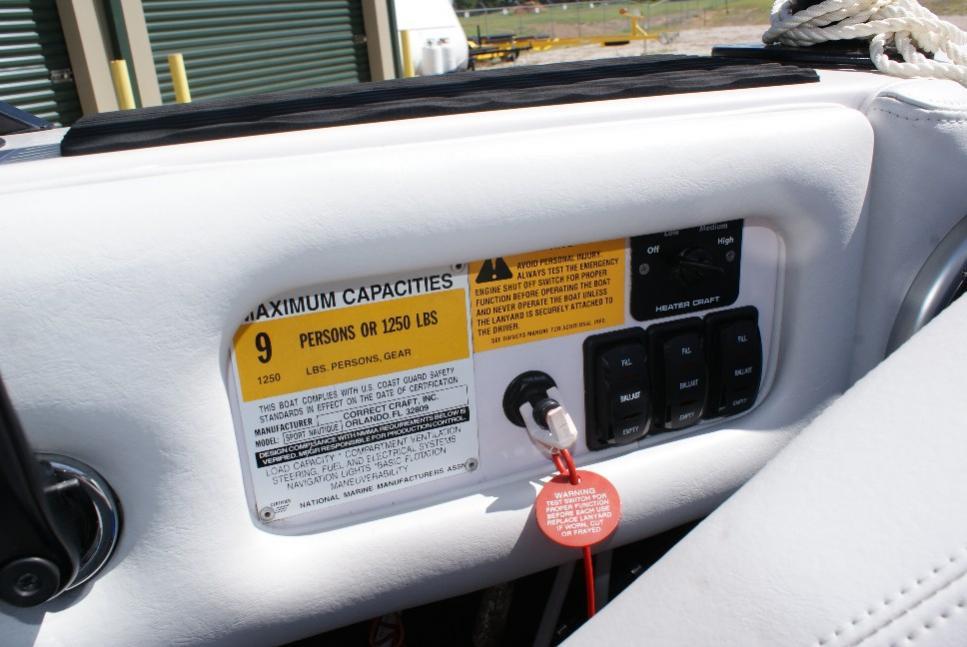

                          Okay, here are some "finished" pics. That said, I plan on carpeting the floor piece and building a fiberglass panel that goes between the pumps and the bags. I also need to check those factory check valves, which don't seem to be letting water out.
                          I only had one person with me today, so we did not have anyone to film the wakes. I will do that tomorrow.
                          Note, when we ran today for wakeboarding, I had all the sacs full. The wake was fairly clean, but only had so-so pop. I drained the bow sacs for about 30 seconds (so figure 3/4 full) and the wake became totally clean, more vertical, and a lot poppier.
                          Second note, it took 2:57 to fill the rear 2 bags. I consider that very fast. The front 2 bags, which run off 1 pump and have the ski locker bag flow deliberately constricted by the ball valve were more in the 5 and a half minute range. I did not get an exact time because I messed up the process. But it was roughly twice as long as the rears, which makes sense.

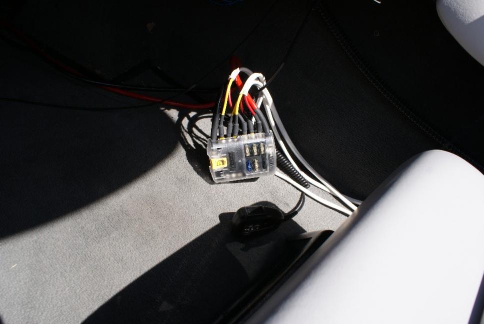

                          Third note, the fuse panel is now adhered by industrial velco to the side of my subwoofer. I'll take a picture tomorrow. It is basically hidden, but accessible since I can (a) pull my sub out very easily and (b) because it is velcro'd on.
