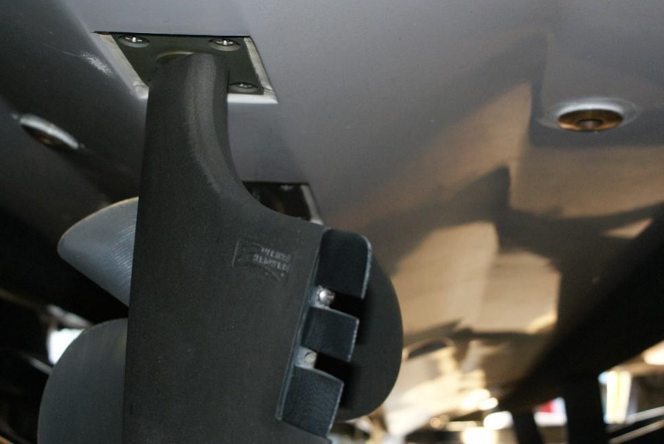

          If you don't want to cut them out, you are going to have to unbolt the gas tank and move it forward. You do not need to disconnect the gas tank hoses. You will then need to get the vent hose (top) and intake hose (bottom) off. If you can get these off without cutting them, great, if not, cut the vent hose as close to the tank as possible. You should be able to tie into the 2 vent hoses with your new bag system. I ended up using new short pieces of 3/4" hose and connected that to the stock check valves. If you are using 1" vent lines, you will need the full length of vent hose and probably new thru-hulls. Others have gone 1" in and 3/4" out without a problem, so that is what I am doing.
          Once you get the hoses off, you should be able to maneuver one of the tanks so that the inside edge sits on top of the other tank's inside edge. You should then be able to slowly rotate it out. Once you get the one out, the other is pretty easy, just do the same inward rotating motion. By that I mean, I stared with the tank on my right (looking toward the back of the boat). I lifted up the inside part of the tank and rotated is counter-clockwise and I think also rolled it toward me until it came out. You will figure it out.

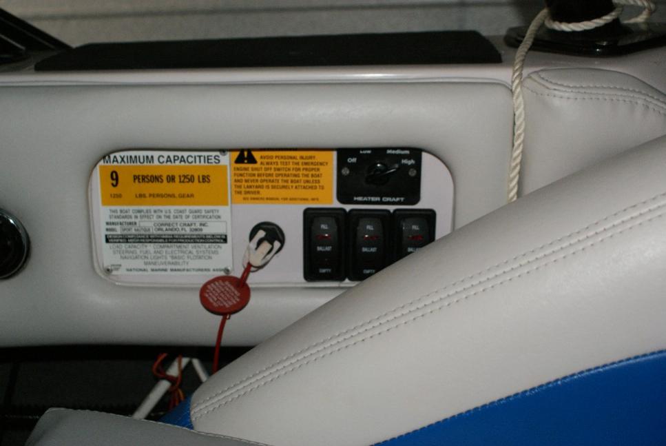

              Note, if you plan to put your switches in the throttle pad where the rear hatch lock mechanism is, you may need 3 single conturra mounting brackets instead of 1 triple unit. The hole on mine is a bit too long for a triple unit. You can find the single brackets at genuinedealz.com for less than half the price of the other places and you get free shipping on those parts. I have not received mine yet, but I think they should work. 3 singles is wider than 1 triple.

                Regarding the switches, I have three single switches which came with my Jabscos and was not planning on mounting them where the trunk latch is... I was thinking about putting them in the spot where the seacocks for the old ballast system is or perhaps where the guages for the hard tanks are, although that would require a refab of that panel. Where can I find a three switch bracket you're talking about?

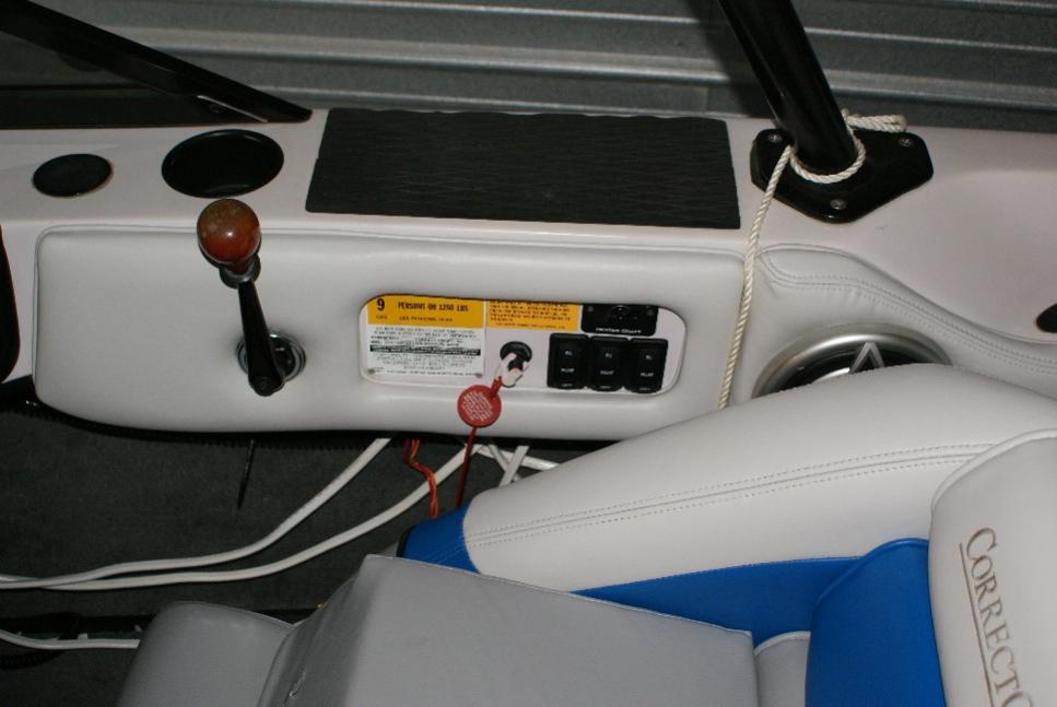

                  I probably would not mess with the hard tank gauges. If you put the switches where the seacocks were, you will need to build some kind of mounting plate for the switches. I could look pretty good, but requires more work than I want to do. I might move my coast guard plate and put the switches there instead. I have not decided. I have extra silver cloud vinyl from when I redid my vinyl, so I could probably make a custom bracket below look pretty good... now you have me thinking. You can find a three switch bracket also at genuinedealz.com or for more money at West Marine.
                  I am using 10 gauge wire for the pumps and switches as that is the fattest wire I can get and still use quick connect fittings for the switches. I am using a blueseas 6 blade fuse block. I will either wire it directly to my battery using 4 or 8 gauge wire that I happen to have lying around from other upgrades I did or I will wire it to my amp distribution block. I will likely mount the new fuse panel on a custom mini driverside kickplate I have that has my heater vents in it and sits on top of my dual 12 inch sub box. This would put this fuse box close to the switches. I want my 10 gauge runs as short as possible, and they are already a bit on the long side for peak amp draw.

                    the supports are ridiculous... who thought welding that bolt to the support t was a good idea? and then to have the nut on the bottom side underneath! seriously? and then the bolt on the vertical support post? sandwiched between everything...
                    I don't have the tools for the job, I'm going to have to take a second run at it with some better tools
                    did you undo all the vents and fill lines to the gas tank to get the hard tanks out? or just unbolt the supports and push it as far forward as possible?

                      No, you don not need to undo any of the gas tank hoses. But, you will need 2 small socket wrenches or crescent wrenches, and ideally another person. I did mine by myself and one of my wrenches rachets kept slipping (a Craftsman by the way with about 1 hour on it). This reeeeaaaalllly sucked. Yes, this is over-engineered, which I typically like, but not this time. This is one of the worst parts of this process.

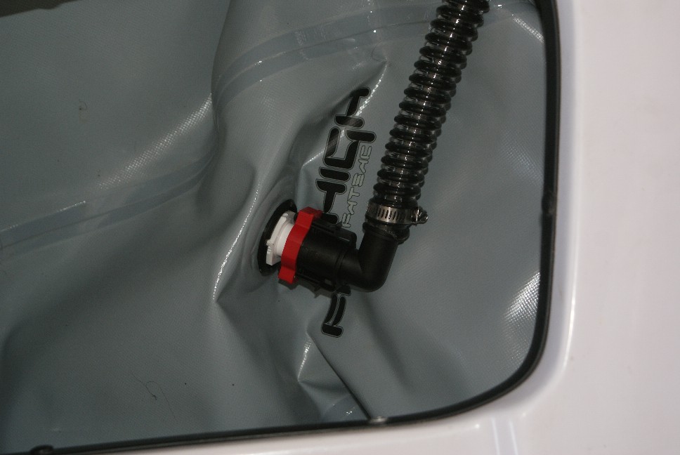

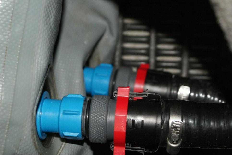

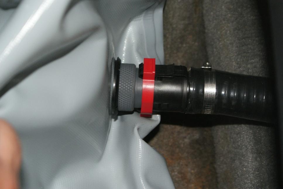

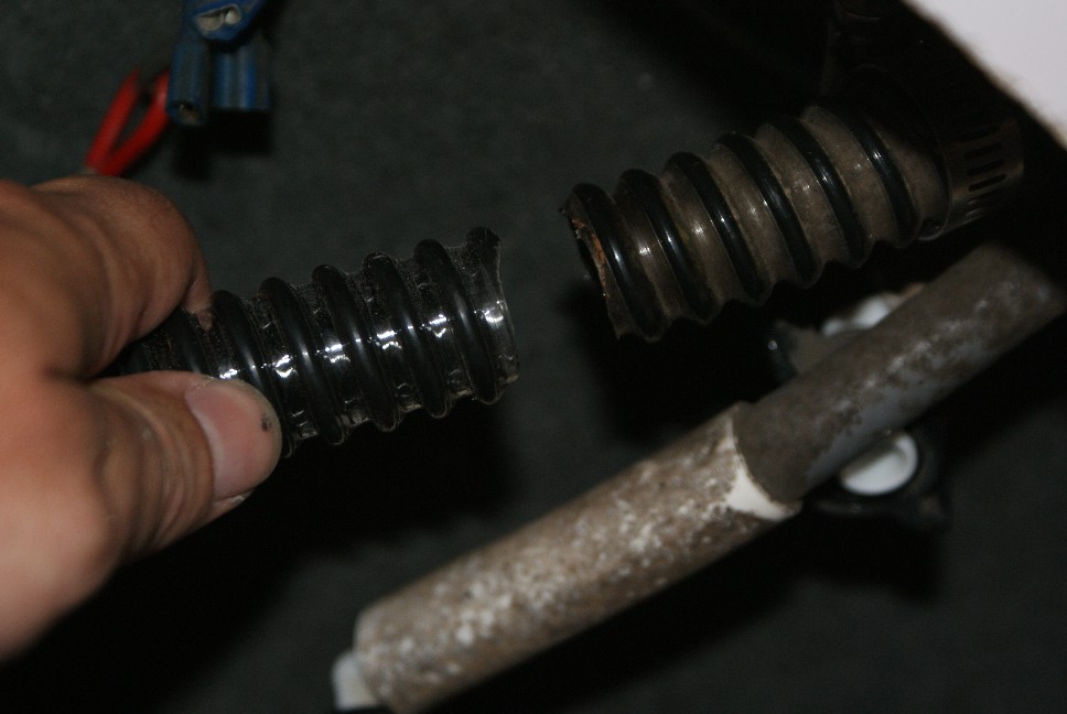

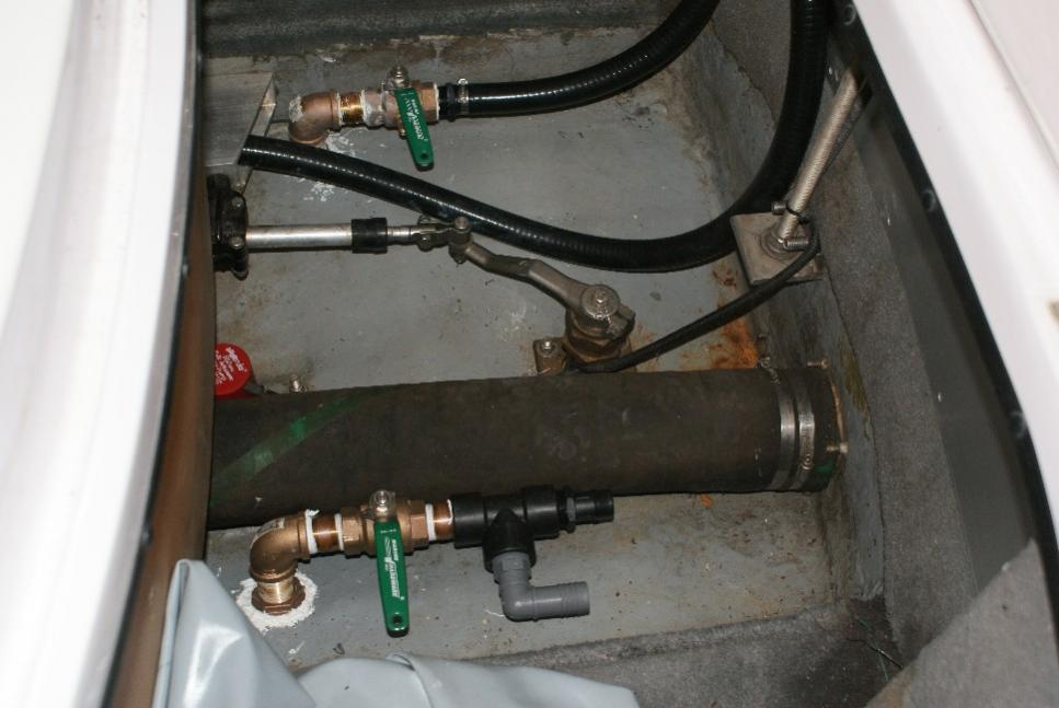

                      So I got a bit further today and have some answers for you, some pics, and some lessons learned.
                      1. The vent line out of the seacock controls for the factory ballast is confirmed 3/4". See pic below.

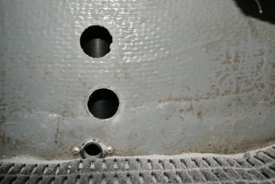

                      2. If you put thru-hulls in the way back where I put them, you have to be very careful (more careful than me) with placement. Also, I don't think anything bigger than 1" will work back there unless you can cut down the thru hull. I can't decide whether I prefer the thru-hulls on the angle or on the flat part of that back area, I ended up with one of each. Either way, you have to be careful that you have enough flat surface underneath with no angle changes for the mushroom flange. You also have to carefully measure things so you can actually turn them tight. This I did fortunately, but I could have gave a bit more thought and measurement to the exact placement. I could have had them pretty much symmetrical had I tried. Be sure you put the ball valve on the right way so you have clearance for the lever so yuou can actually open and close it. This may require reversing it on one side if you are going for symmetry. Also, be sure to test the full arc of the rudder control so you total clearlance for that.
                      Note the ball valve on the thru-hull to the top of the picture does not line up with the pre-existing hole in the removable floor board. I could not get it to do so due to that useless aluminum piece you see the hose going through (I put that hose there). I will have to drill a new hole in the removable floor. This is also somewhat necessary because that ball valve sits a bit higher than the other (due to placement) and the floor actually just barely touches the top of the lever. I don't want any pressure on that, so I need to cut the hole in the floor for that too. No biggie, just a pain.
                      3. Wear glasses, gloves and long sleeve shirt when cutting thru-hulls. Fiberglass is fiberglass and is itchy... and now so I am I (I only wore glasses).
                      4. Have the right size hole saw. My first was a little big, so I had to fill in with adhesive (only a very little bit big). So I went one size down on the second. This was too small, so I spent the better part of 45 minutes carefully drilling (with a normal bit) and using a rounded file to enlarge the hole, testing it frequently. I finally ended up with a better fit than the first one, but it was a PITA.

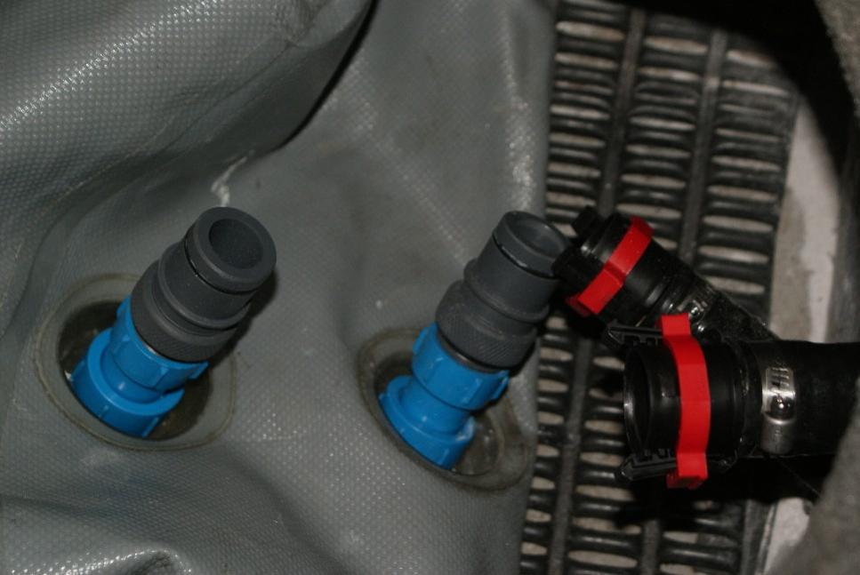

                      5. The Fly High quick connects 1" are a super pain to get into the black Wakemakers 1" hose. I cannot explain how difficult this really was. I had to lube up the barb and the inside of the hose with a thin layer of grease and heat up the hose with a heat gun. I then still had to use a towel to grab the quick connect and twist it in (kind of sharp edges on the quick connect without the towel). Even heated up and lubed up this was pretty difficult. The other barbs have not been anywhere near as difficult. In fact, I'm a bit worried about the barbs on the pumps as they hose goes on way too easy there. I'll definitely have to use 2 clamps on each side of the pump if I have the room to do it.
                      ***IMPORTANT*** When using a heat gun, be very careful. If you are using it on your boat, it can and will destroy vinyl and melt the olefin carpet, so be sure to have a shield between the hose and your boat when heating it up, and don't forget you need a place to rest it when it is cooling off. Oh, and don't burn yourself with it either. I have done two of these things myself already.
                      6. Try not to do this work when it is 100 degrees (like I did) and bring plenty of fluids if you do (fortunately I did).
                      7. West Marine carries quick connect adapters that are 1 female and 2 male. This should work well for where you need to cross the lines on the conturra switches.

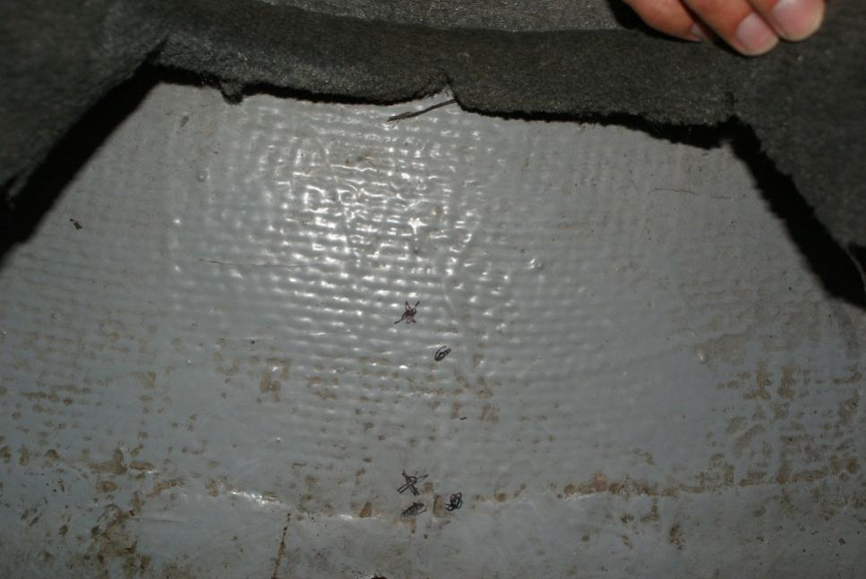

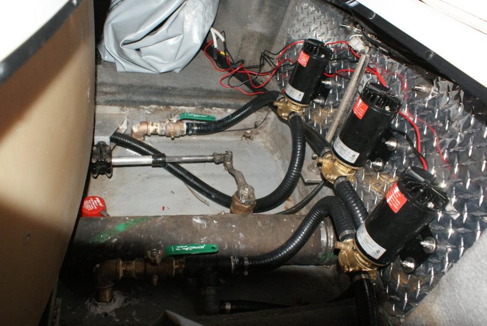

                            I will post pictures tonight, but I finally got everything installed and tested. After troubleshooting a bad crimp I did on one of the switch wires, everything works.

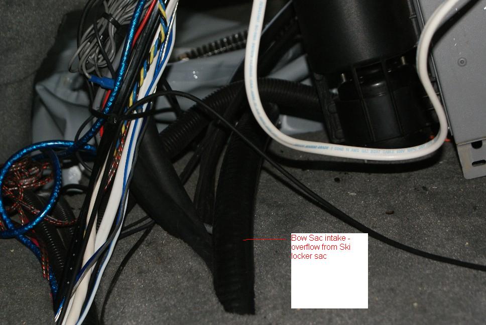

                            However, I am not sure that my piggy back system is the best system for the belly and bow sacs. On my test, which was done at the launch on my trailer, when filling the belly and bow sacs, the belly sac got very very full before sending water up to the bow sac. This is probably normal and just part of the design, but it did worry me (I had visions of the bag bursting or the water bed fittings flying off). I am contemplating a slight redesign where I split the intake hose via a T in the engine compartment (mount the T on the floor as low as possible) and running 1 line off the T to the belly sac (with no vent) and 1 line off the T to the integrated bow sac, which is vented out the hull. I am thinking that if the belly sac fills up first, which is likely as it is not as much uphill as the bow sac, that the water would take the path of least resistance and continue to the bow sac (i.e., I would not burst the belly sac). I think that if the T is mounted low enough (i.e., below both bags), emptying should also work. Anybody see any problems with this design? I think it would work a little faster and put less stress (or at least for less time) on the belly bag during fill ups.
                            Note, Johnson pumps are fast and very loud. There is no way you are not going to hear the sound change of the pumps when the bags are empty.
                            Stuff I still need to do:
                            1. Make a custom floor piece for the rear locker that is a bit shorter than the original so that I can lift it out if/when needed. The pumps are a little in the way as is. Also, this way I can easily cut custom access holes for the ball valves. I intend to use 3/4" plywood reinforced with West epoxy system and fiberglass. I will cover this with gray marine carpet (either HD or Lowes has some that should work).
                            2. Finish a new custom driver kick plate for above my sub and mount ballast fuse panel to it.

                              Here are some more pics. I still need to zip tie the wiring and build and install my custom floor.
