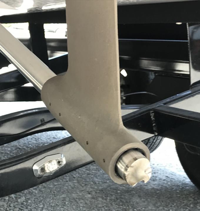

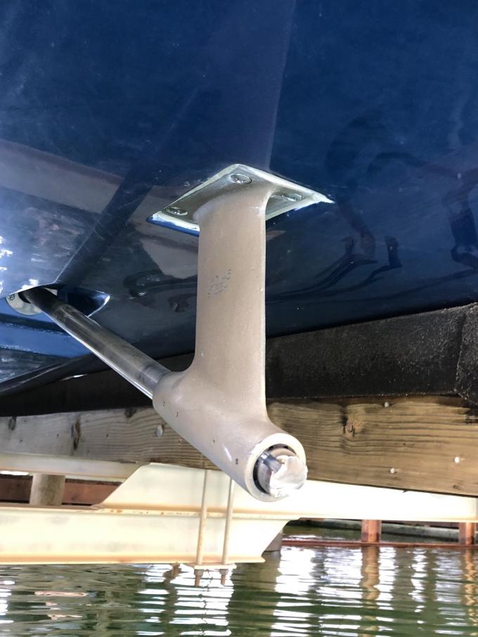

    My G23 2017 with 378 hours just scrummed to shaft break while surfing today. Another one bites the dust.

  • greggmck
    replied
    It would be great if you could rotate the prop shaft to get a picture of the key way. Every shaft failure I have seen has the key way cut extended nearly to the strut. The "new" shafts have a shorter key way that is completely covered by the prop hub and well short of the strut reducing the weakness caused by the key way cut.
    Sent from my SM-G965U using Tapatalk
