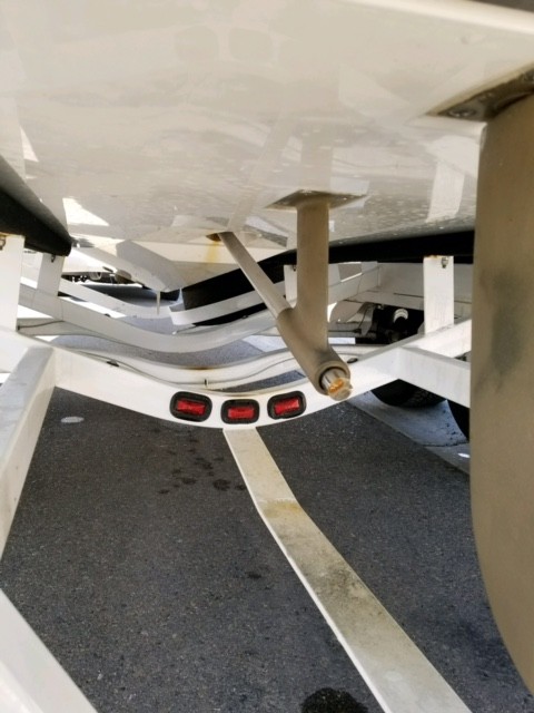

    I was at Lake Powell this week with a buddy. I have a 2017 G23. He has a 2016 G23. Both with the 550. We left a couple days before they were going to leave. He ran up to a place called Dangling rope. 30 or so miles up the lake from where we stay. While up there he broke his shaft again. He was stranded over night until he could get signal enough to call for tow services. After a 5 hour tow the next day he is finally back. He then told me this is the second time it has happened!! Not sure what happened the 1st time but he is pissed now. Ruined his whole week with his kids and grandkids. He has a great relation with the dealer so I will let you know what they say. His words to me were " I never want to see this boat again. I have no confidence that it won't leave me stranded again." Reading all of the others that this has happened to makes me a little nervous.

    Hey guys - I am the original owner of the boat. For the first 2 times Nautique sent me a new shaft and prop, since after the shaft snaps... it's gone forever on my 120+ ft lake.
    I do a lot of hours on my boat, but so far shaft breaks +/- after the same ammount of hours.
    I am waiting for an answer from them about my 3rd one...
