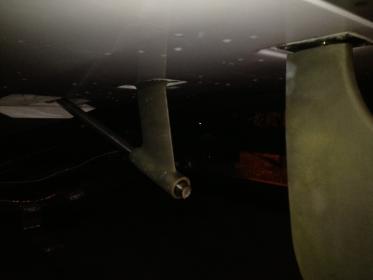

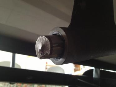

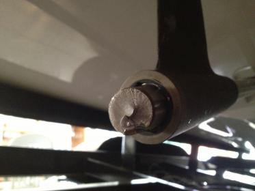

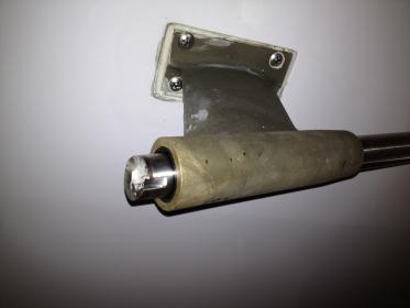

    I frequent this discussion board and read about the G23 with 550HP motor prop shaft issue as it happened to another member months ago and mentioned it to my dealer when they had my boat for a month to finish up warranty work back in June. They said they had checked the bulletin and everything was good on my boat .... Apparently they were wrong ....
    Two days ago I was out on the big lake for a cruise and on our way home noticed some slight vibrations traveling at cruising speed of 45 km/hr. I thought it was odd so I stopped and hopped into the water, checked on the prop/rudder noticing no damage, seaweed or anything else of concern. We then continued and the vibrations slowly got worse and I continually was decreasing my speed to avoid damage. I got under the boat 2 more times to check on everything, I had no clue what it was but the prop nut was on tight with the cotter pin still installed and I could not see anything of concern. It got to a point where I was traveling just off idle (about 12 km/hr) because anything above the vibrations were so bad the steering wheel was shaking. Keep in mind at cruising speed we were probably 1.5 hours from home.
    Without warning at such a slow speed we heard a *tink* noise and the engine RPMs increased.... I pulled back the throttle and shut the engine off. Knowing exactly what had happened I went under the boat again to verify, and behold no propeller.... Great.

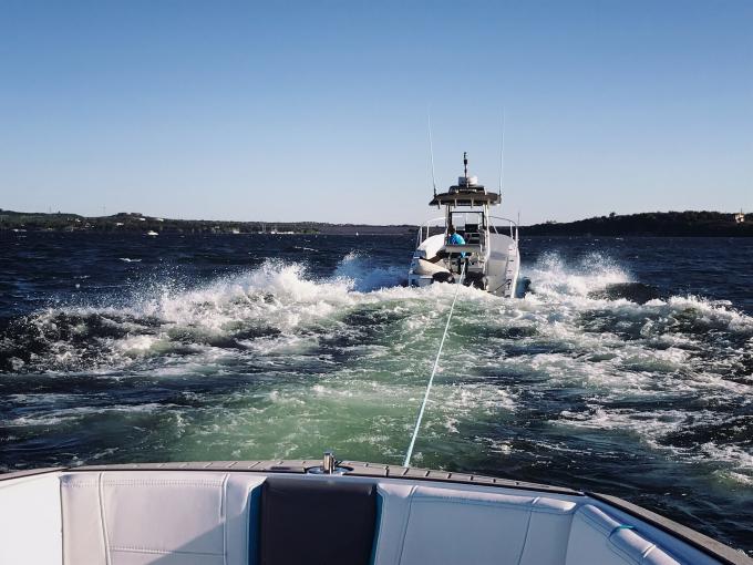

    I am not sure if anyone has towed a G23, but it is a beast. it took us 6 hours from that point to get home. I am not very happy, especially since I am very keen on the operation/maintenance of my boat and brought up this exact issue with my dealer to ensure we were not left stranded.
    We got the boat last year in august around this time and it only has 57.7 hours on it.

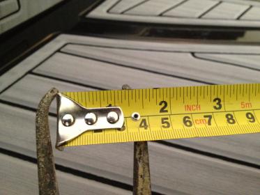

    I measured the prop shaft and it is 1-1/8" diameter. I have the XS550 motor, and from what I remember the issue was that the shaft needed to be thicker? I was wondering if anyone can comment/knows what the issue actually is? I am very keen on getting my boat fixed and back on the water ASAP.
