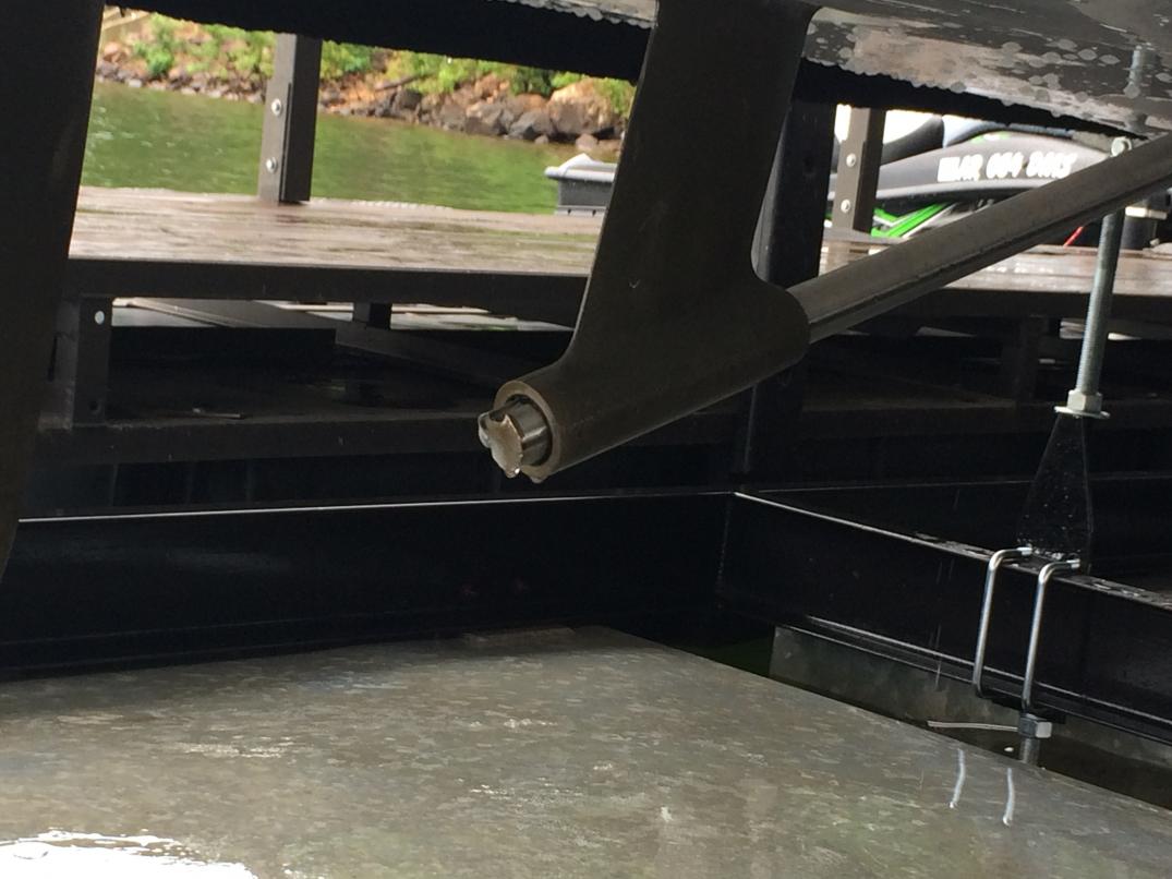

                2014 G23 Prop Shaft Broken
                This happened yesterday after about 5-10 minutes of driving 23mph while pulling a tube. All sudden a bad vibration started to happen so I pulled throttle back. Applied throttle again and it was still there. Idled into dock and when I was positioning boat into slip I put into reverse a couple times. On the second time I felt a slight thump and lost all propulsion. Raised boat and this is what I saw.
                Boat has 50 hours on it and to my knowledge has never hit anything (bottom etc).
                Anyone seen anything like this? Frankly, I can't wrap my head around the physics of how this thing just shears off.

                    Uh-oh, another one. Glad you made it back to dock. Is the boat a 450? I have to say I was pretty nervous about this happening to us while 50 miles up lake on Powell last week. Fortunately, everything was fine and we are at 70 hours on ours. I hope Nautique gets this figured out soon. Nautique has told me there is no way to examine the shaft for a likely problem. Great boat but they need to do something about this.

                      Yes it is a 450.

                        Yet another data point that confirms the infant mortality theory on this.... That all these shaft snaps seem happen between 30-70hrs. Get past that, and you are in the clear.
                        Gunners, yes it's happened to others, roughly 15 or so...they'll warranty and replace it... It'll not happen again. Sorry to hear about your troubles.

                            Certainly disappointed that this happened 5 minutes into our four day weekend. Also annoyed I have to trailer it 5 hours from the lake house to get it repaired.
                            Having said that we've already been in contact with Buxton and they are ordering the parts on Monday and will have it fixed prior to our next visit to the lake.
