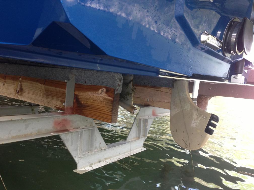

THIS IS NOT BS!!!, - Here you go for all you doubters, less than 8 hours on a new 2013 G25 with 550Originally posted by Nautiquehunter View PostPretty much everything regarding Nautique on WW is BS. They were also saying the transmissions were blowing on the Gs . WW is all about trying to convince people that MB,Axis and Sanger are just as good as Nautique for 1/2 the cost.
I dont care if you have 2 hours on a boat, if you hit something, the shaft will break. It looks to me, it did it exactly as it was designed and sheered off to save the tranny...
With just a single post on this forum, you better have a little more data than just a pic. Sorry to pick on you if your a newbie to the site. We are all pretty passionate about our boats on here, and we need more data if your gonna go down this road.

The BS part was that this was a widespread issue and a fundamental design problem with the G23 / G25. It was rumored that Nautique would have to change the whole design and layout of the transmission / driveshaft. It seems there are some reported cases, including yours. However, I am not sure that makes it a widespread problem. There are many with G's that have a lot of hours already without any issues. Unfortunately, this doesn't make you feel any better. Hopefully Nautique steps up and resolves your issue.Originally posted by Tabiggs View PostTHIS IS NOT BS!!!, - Here you go for all you doubters, less than 8 hours on a new 2013 G25 with 550

What does make me question the above picture: why is there all that seaweed like debris wrapped around the driveshaft and its mount? Was a submerged object hit or did the prop bottom out in the lakebed?Last edited by lion90; 04-08-2013, 01:18 PM.
Rudder looks straight and undamaged. It will be interesting to see if boat hit something or not. Wasn't the claim that it shears off without hitting anything?
But really I think this is more complicated. A prop should not break off from hitting just anything. Lot's of times you get a damaged prop because you hit something, the prop sustains damage and you move along with your damaged prop. It is possible that drive shaft is too small diameter for weight of boat.
I personally would like to know diameter of drive shaft across the nautique line and compared to other mfgrs. That would be helpful. It just seems to me it would need to be bigger for bigger boat.
Is the bottom of the hull damaged from the prop sheering off? If it was spinning when it came off I would think that it would have nailed the bottom of the boat and not fell straight down.

What does make me question the above picture: why is there all that seaweed like debris wrapped around the drive-shaft and its mount? Was a submerged object hit or did the prop bottom out in the lakebed?[/QUOTE]
Yes I am a newbie, and I was curious about other potential problems since this happened yesterday so I did a search on google and this topic came up. So I regestered to this site, never been on here before, that is true.
Here is some additional information
My dealership made house call to my lake house 2 weeks ago to check out the shaft, he didnt tell me why but said there were some issues with the boats made in 2012 that were model 2013. He went on to tell me that my boat had no issues and that the shaft was fine.

I did not hit anything, I know for a fact that I did not. There is no other damage to the boat that I can see, (hopefully), this was a clean break and appears that stainless alloy which the shaft is made failed, this all makes sense now based on the dealership information that they were checking for. You would also think if I hit something, I would have to hit the object extremely hard, and there would be other damage to the rudder or other impact evidence, A shaft should never break like this - props bend and shaft bend before this should happen, right? My opinion but this makes sense to me.
Here is Austin Texas, we have duck weed - debris - , its hydrilla type seaweed,- It has no effect on the integrity of the shaft or any of the 1000 wake board boats that are on this lake. It congregates in shallow water. I hate it but until they drain the lake, and we get out of this drought, we are stuck with this on Lake Austin.
I own the boat and the dealership has agreed to handle the problem. I received an email yesterday from the sales person that apoligized and agreed to handle the damages.
This is true and I not sure what else you need from me to prove there are shaft issues (my opinion) on some of the newer boats,, or that I own the boat, I really enjoy my G25, its been a fun boat so far. The only other issue I have had was a horrible belt squeaky noise that was horrible at low idle when I first took possession of the boat , The manufacturer issued a new bracket that goes in place of the old belt bracket, might be the belt to the alternator, I really don't know, but they were able to fix it.
do you want to see my sea tow receipt?
