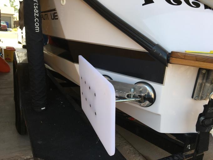

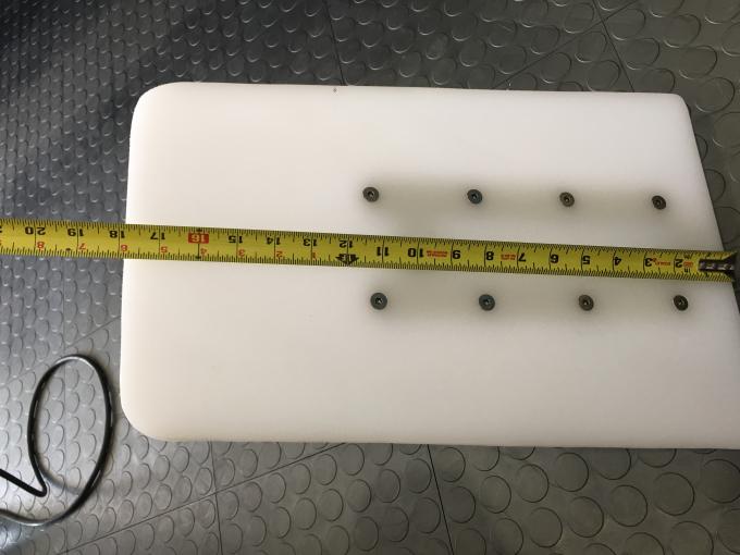

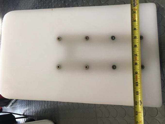

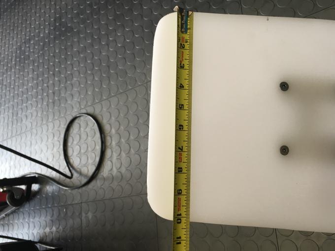

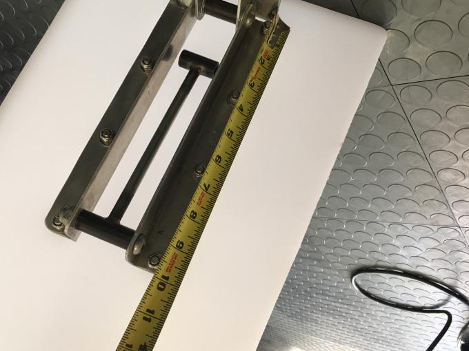

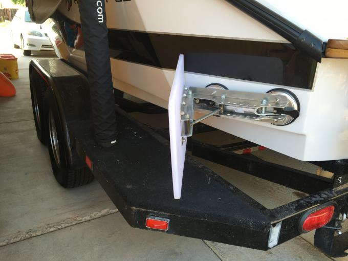

  • Brian Sullivan
    replied

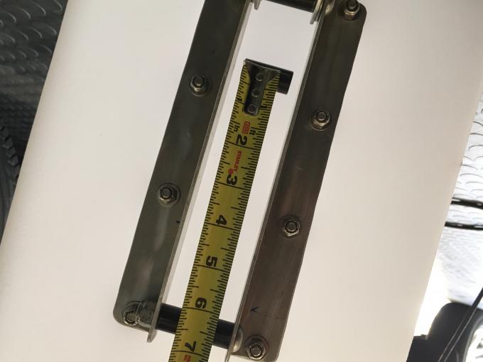

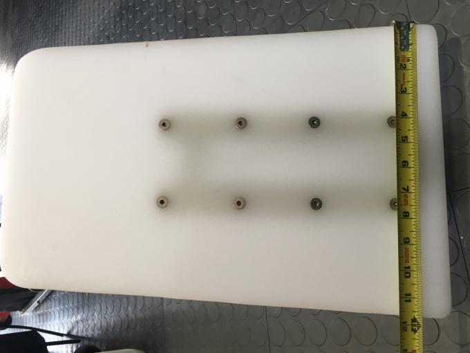

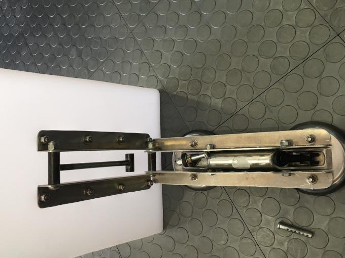

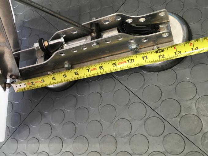

    Here's mine I copied one of the first ones but didn't like the straight 90 degree angle felt like it wasn't efficient and just dragged too much so I made an adjustable one and copied Malibu's surf gate size. Im running it on a 2001 SAN so we need more help surfing the port side than the starboard side which is where the adjustment comes in. As for the angle to the side of the boat it can be adjusted between 10-40 degrees the sweet spot for the port side seems to be right in the middle around 20-25 degrees. I attached pictures with some of the dimensions if anyone wanted them.
