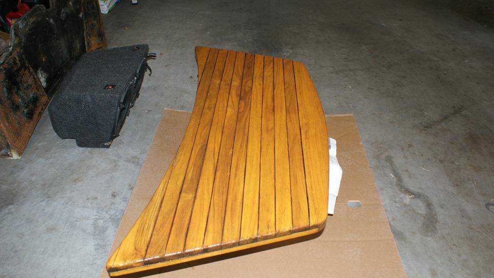

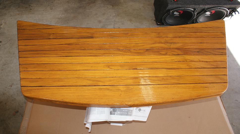

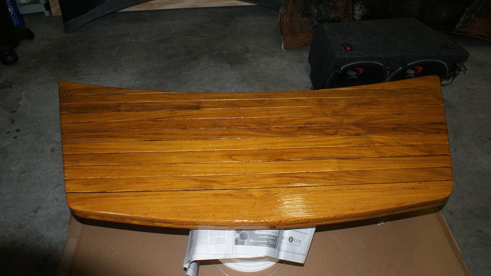

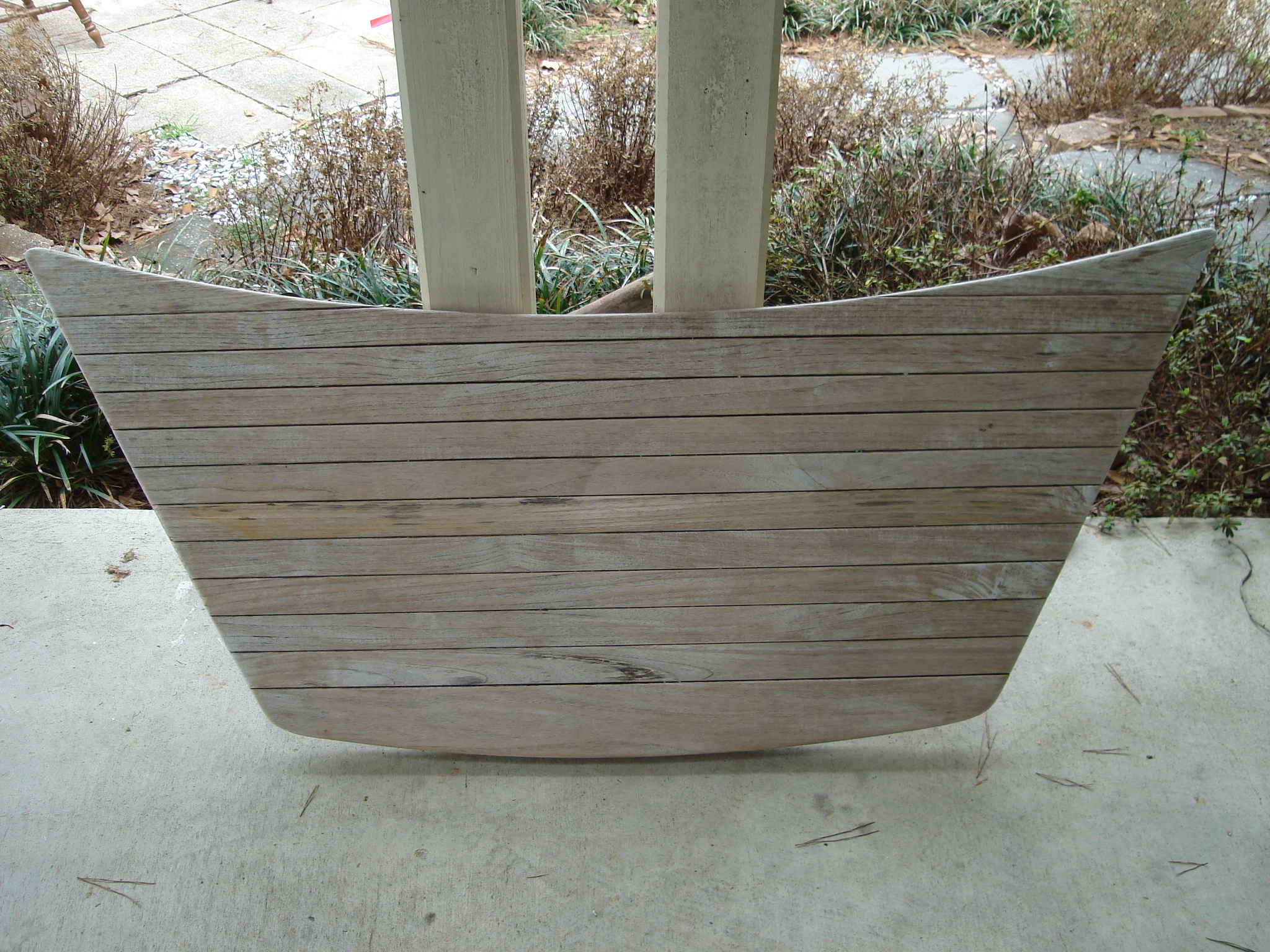

          Because I am a dumb ***, I forgot to put the memory card back in my camera before I took several pictures of the first coat after drying. My camera does not scream at me when I do this. At any rate, the result is that I have no pictures of the first coat dry. Here are some of the 2nd coat just after application. I will try not to be a dumb *** in the future.
          I agree about the color of the Cetol Marine. It is not for everyone. Although now they have 3 colors, with 1 being lighter and the last being almost clear called "natural teak." I think the color will look great on my boat, but my boat's primary color is blue, and blue and this yellowish orange should look very nice together. Might not be great with reds.
          I also think a large part of it is the actual teak. Wake_fun's color turned out a lot different than mine. Same Cetol Marine color. Thus, the difference must be due to the actual wood. If anyone is in the DFW area and wants a small amount to test or to see mine in person, PM me.

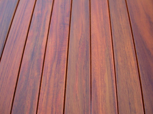

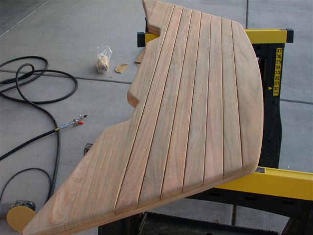

            I think it's the wood that makes it different. Here is mine.

              I think CC might be slipping in santos mahogany (cabreuva)(Myroxylon balsamum) instead of teak on some of these platforms. Santos mahogany can have that beautiful reddish color. Wake_fun, your swim step looks a lot like the floor I had put in my old house.

                      I used a DA and sanded on mine a lot with two different grits, down to fresh wood. I never hit any screws. I also used the edge of folded up sandpaper to do the cracks between the wood. Here are the pics after the sanding........

                          Wake_fun, I can see the reddish tint in the pictures of the sanded wood. Your teak has a natural reddish tint. Lucky bastard!
