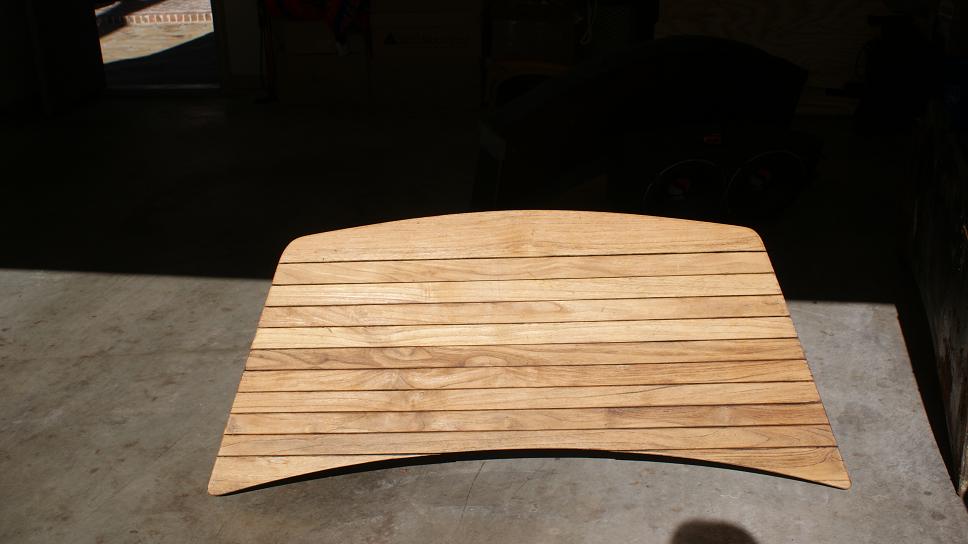

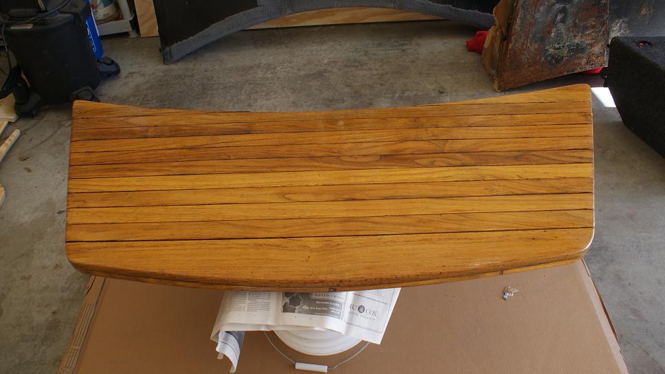

        FYI, you dont need to do all 3 steps of the starbrite- I only use the cleaner and the oil. Ive never tried the Interlux. Ive never had any luck changing the color of the teak with the oil- Ive used a mixture of teak/ATF/linseed oil, as well as several different teak oils and the color always comes out the same. My dad's 196 is much darker and redder than mine and we use the same stuff- so coloring really has a lot more to do with the natural color of the wood than the oil thats used, IMHO.
        Is that Cetol Marine finish one of those paint on products? Its not a teak oil correct? Those have never looked quite right to me- too orangy and unnatural. Im sure regular oiling will be somewhat more maintenance, but you sure cant beat the look.

            My dad's, yes- mine, no. I bought my '90 in '05 with 1100+ hrs on it. The platform was covered in polyurethane and a lot of mildew. I had to completely disassemble it and sand the finish off, and the cleaner and a brass brush brought it right back after that. The pic above is actually pretty old- I tried a new method that involved wetsanding between coats of oil last winter. The platform looks 100% better and will only need a few touch ups this off-season. When oiled it looks pretty darn close to a fine piece of furniture. Ill have to get a pic.

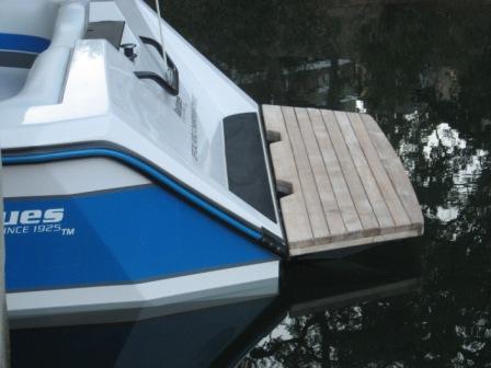

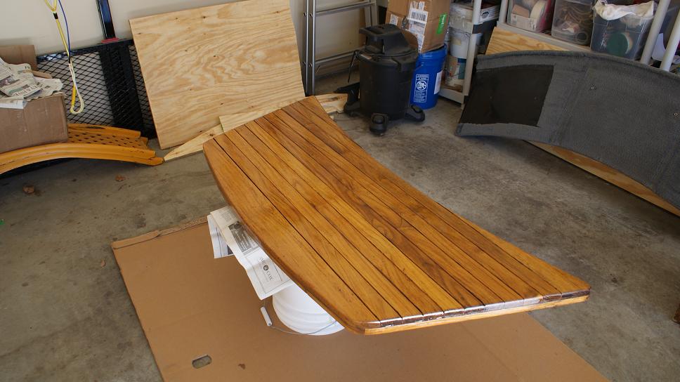

                    RE: Re: RE: Re-Finishing my Teak Platform
                    I've heard that one should never sand teak but I if you have very rough edges I don't know away around it.
                    I recently redid my teak swim deck and used all three steps in the Starbrite system. I did notice a difference after using the brightener - which I did not think I would.
                    Attached are a few pictures along he way.
                    Pic#1 - as was
                    Pic#2 - using cleaner
                    Pic#3 - after cleaner and brightener
                    Pic#4 - 5 coats of oil
                    T
