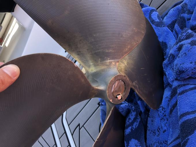

                            #628
                            Happened to a friends 2016 G25 this past weekend at Lake Powell. Strange vibration started. He flagged me down (I was in my boat) and I jumped in with him (my son took over driving my boat). Idled back to the ramp while telling him about this forum I'm on and the prop shaft issue discussed there, thinking the whole time that the chances of that being the issue were slim. Got to the ramp and coasted the boat on to the trailer. He put's it in gear and gives it a little throttle to move up the trailer and there was a small "tink" sound and then the engine revved. He shut down the boat and I jumped in the water behind - the prop was laying on the launch ramp, dented from the drop. His local dealer in UT had a shaft and prop in stock and another friend was headed down that evening - so he picked it up and brought it down. Shaft and prop were replaced and a little more than 24 hours after, the boat was back on the water - good as new. There had also been a slight "squeaking" sound when in gear before, but that sound was now gone. The guy who did the work said the coupler was loose when he pulled the shaft off, so maybe that has some bearing? Anyway - thought I'd add this account to the pile here.

                              Wow! Who is the dealer? I need to add their contact info to my phone.
                              • bdisney3
                                • Feb 2016
                                • 205
                                • Phoenix
                                • 2021 G23 (on order) 2018 G23 (for sale)
                                #630
                                Nautique dealer in SLC (where boat was purchased) is Croft Marine - there's no Nautique dealer at Lake Powell, so it was the Mastercraft dealer who did the shaft/prop replacement.
