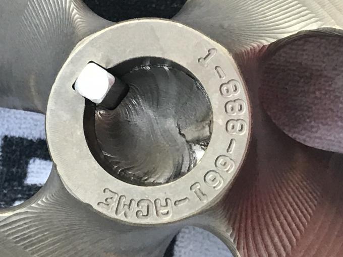

          Thread revival! Buddies shaft snapped in shallow water so we were able to retrieve the prop
          2012 SANTE 230
          • Infinity
            • Sep 2017
            • 730
            • Lake Norman - Denver, NC
            • 2014 SV244 w/ ZR409
            #275
            Wow, pretty cool to see the other part this time. Clearly a stress crack that caused the failure. Ar they still saying this was a bad run of shafts, or shaft is not big enough to withstand the torque?
            • wakerider107
              • 271
              • south
              #276
              bad run of shafts due to poor metallurgic process or something like that. no rhyme or reason to when it happens

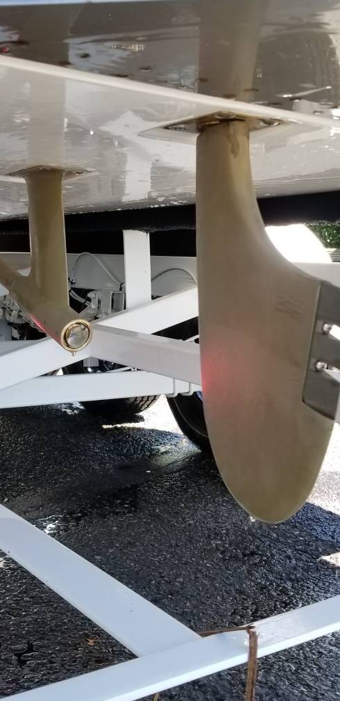

                        #281
                        Shaft on my 2018 G23 H6Di sheared yesterday while surfing. 88 hours on the boat. Some brief vibration then lost the prop. I hope Nautique gets to the bottom of this. I am a long time Nautique owner but this really concerns me now...
