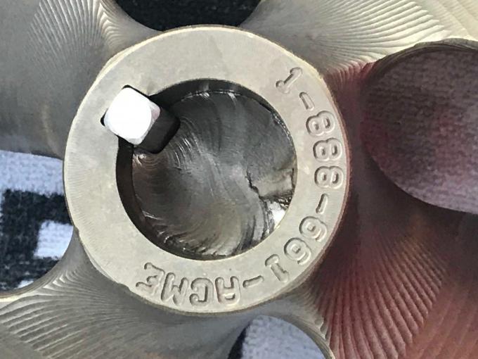

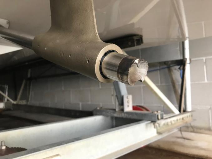

            I have a 2016 G23 which I purchased 6/16 my first shaft sheared off 7/17 with approx 45 hours. I just had my 2nd shaft shear off 6/18 at approximately 70 hours. Was told it was a vendor issue and now being told the same thing again and that they are now on there 3rd vendor. I have to travel 6 hours to have it repaired. I do not want to go through this again. Has anyone switched models or done anything to prevent this from happening. I otherwise am happy with my G23.

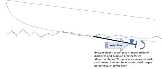

                              WHAT I LEARND ABOUT PROP SHAFT SHEARING:
                              Being a professional engineer for over 30 years I decided to dig into what caused the shaft to shear in my 2018 G23 H6Di with 88 hours last Saturday while surfing. I have many industry contacts and reached out to a few colleges to help me find industry experts in marine propulsion and propeller design who could provide me with a factual understanding of what happened and what can be done to remedy the issue. After a few days of asking around several people pointed me to Mike (not his real name). Mike is considered one of the industry’s best propulsion design experts and was aware of Nautique’s efforts to remedy this problem. We spoke for about an hour on this topic. He requested confidentiality so I will not use his real name or disclose the company he works for. But here is my experience and what I learned about this failure.
                              1. These shaft failures have occurred primarily while surfing. The loads placed on the prop and propeller shaft during surfing are much greater than wakeboarding or cruising around. While wakeboarders often use very heavy ballast, the boat is on plane while wakeboarding. A planning hull has much less drag than the same hull pushing water at slower speeds. Furthermore, while wakeboarding the boat hull is closer to level with the water surface resulting in the prop producing a more symmetric thrust. This is because both the top and bottom prop blades experience a similar angle of attack compared to surfing.
                              2. During surfing the bow rises higher and the bottom blades of the prop have a greater angle of attack into the water flow, resulting in them producing greater thrust than the top blades. This creates a rotational force on the prop shaft at the interface of the strut and the prop hub. See diagram below:
                              Click image for larger version  Name:	Surf boat diagram.jpg Views:	1 Size:	17.3 KB ID:	559692

                              6. The reason some shafts shear close to the strut while others are a ½ or so away has to due with hub length. Some prop hubs are 3”" while others are 3.4"”. A 3.4"” hub prop has less tendency to shear because it covers the entire taper of the shaft resulting in the greatest thickness of the shaft absorbing the rotational torque of the asymmetric prop load during surfing. That said, I sheared my prop shaft using a propeller hub of 3.4”".
                              7. My advice. If you exclusively surf and are using one of the early deliveries of G23s (October – April) (my guess) there is a very low but real possibility you will experience a shaft shear. It will happen with VERY little warning. The boat will shutter slightly for a few seconds, then minutes later the prop will fall off and you will hear the engine rev if you are applying throttle. Mine sheared while maneuvering to pick up me while surfing. I have the GoPro recording and can post if needed.
                              8. You do NOT need to get in the water to know if you have sheared your propeller shaft. This is dangerous if the water is rough so avoid unless necessary. First check the neutral lock out switch. If it is not accidently engaged, lift the black cooler body out of the small cooler just in front of the engine cover. There you will see the silver shaft coupling projecting from the V-drive. Have someone put the boat in gear while you watch the coupling. If it rotates in different directions while going into forward and reverse, but your boat does not move you have sheared or lost your prop.
                              9. Call your dealer immediately. I called while I was on the boat, he had a shaft sent over-night to his shop and I was back on the water in 48 hours.
                              10. If you surf exclusively keep an anchor on your boat to prevent your boat from drifting into dangerous areas while you wait for a tow. You might want to subscribe to a boat towing service like BoatUS.com.
                              11. Now the 64-thousand-dollar question: Why does this happen primarily on Nautique? To be honest I do not know if other boat manufactures have experienced shaft shearing. But here is what I learned: Nautique uses a surf system, NSS that arguably produces one of the industries thickest waves with strong push. Nautique uses a 2:1 gear ratio to turn the industry’s largest propeller on a surf boat. (It was mentioned that some Mastercraft boats use an 18"” prop. This is nonsense.) See: https://www.ozpropellers.com.au/mast...at-propellers/ Furthermore, the only Mastercraft boats with a 2:1 transmission are the newer X20/X23. But both use a 16.5"” diameter prop. The combination of a 17" prop and 2:1 gear ratio will produce the greatest shaft torque. The only other boat I could find that uses a 17" prop and 2:1 gear ratio is the Malibu MXZ. I do not know if they have experienced shaft failures but there are very few of them around as a sample set too. Also very important, Mastercraft and other boats use tabs to list the boat to produce its wave. The NSS system projects out from the side of the boat which yaws the hull to create its wave, but this increases the drag resulting in greater load on the propeller / shaft. Centurion produces a similarly large wave but uses a 16.5"” propeller and uses tabs to list the hull.
                              It was suggested that 1.5”" shafts are the next step for Nautique, especially if the ballast on the boat is increased in future models. Personally, I would like to see this sooner than later… I hope this helps!
