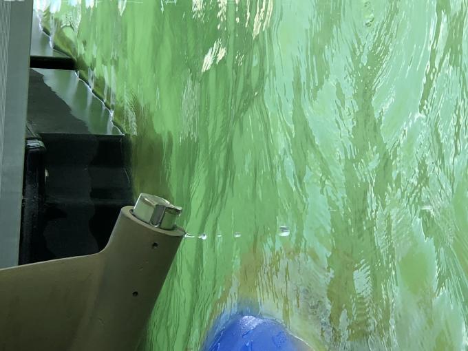

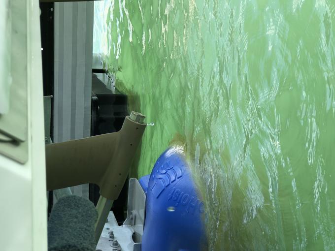

    Today.....friends 2018 G23. Broke in the same spot as all the others. 50 hours
    Looks like this one also has the long keyway. The new one they sent me has a shorter keyway that is below the point where the shafts are breaking.
