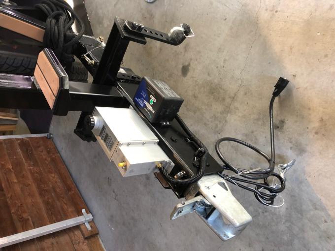

                            New electric over hydraulic disc brakes installed. After bleeding the brakes I took it out for a drive this afternoon - really impressed with how it works. Brakes work great - no lag, nomore "chunk" noise and impact of the surge brake actuator kicking in. I removed all the old surge actuator components and re-drilled and bolted in the original tongue. All in all not that big of a job. Well worth it!
