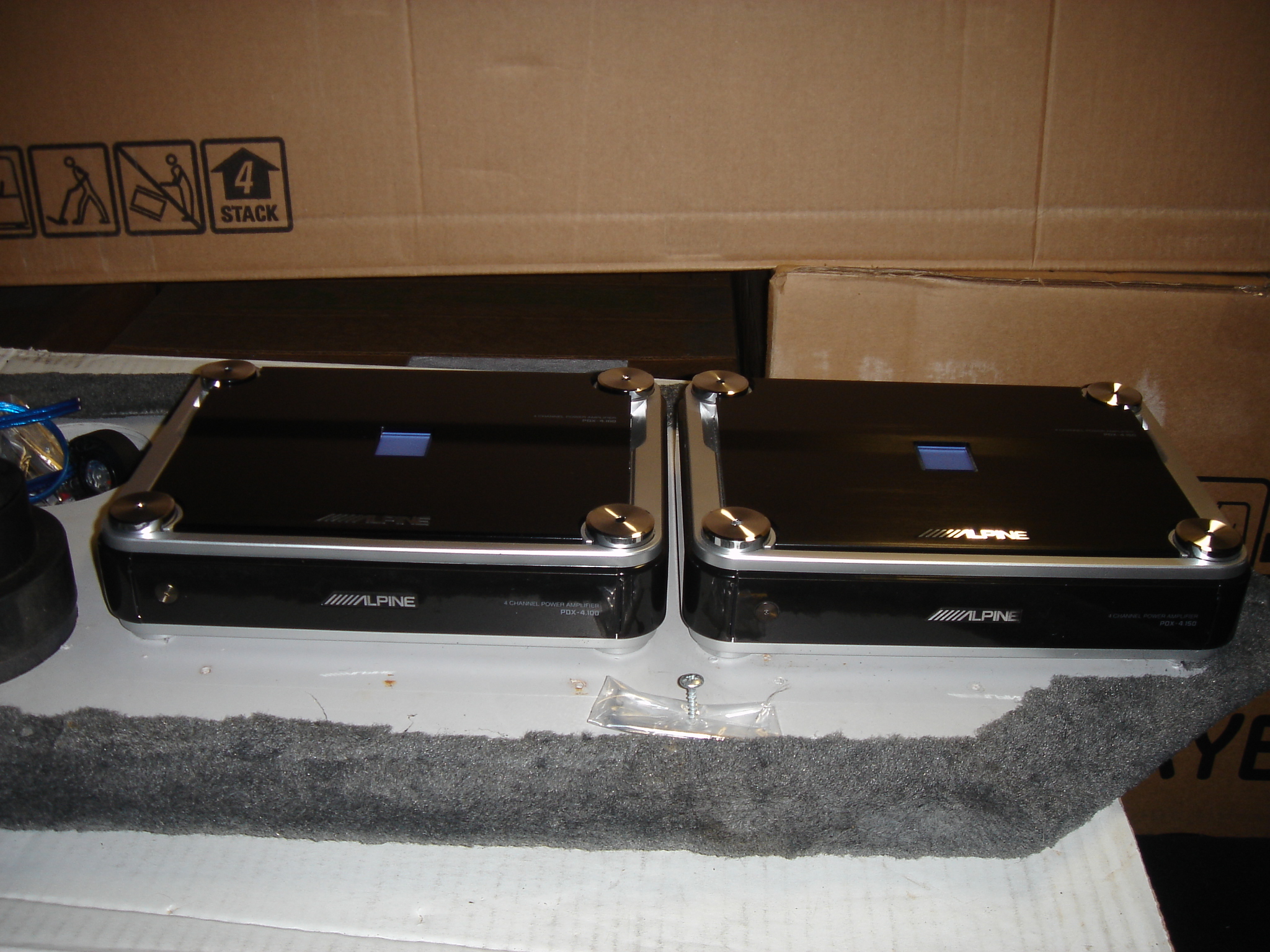

I mounted one amp behind the kick panel, as wake_fun mentioned and also two under the raised deck for the front seating area (bow). I made an "amp rack" out of a piece of starboard and then covered it with matching carpet. I mounted the 2 amps and wired most of it up, including my power and ground distributions. I then slide it in through the front anchor storage (triangle area) and it is through bolted from above, under the largest of the 3 cusions. Kind of a pain to get to, but they are high and dry and out of the way. And really, once tuned, Ive only had to get to them once in 3 years.Past: 82 2001
