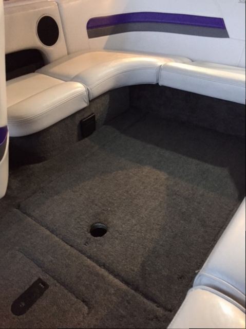

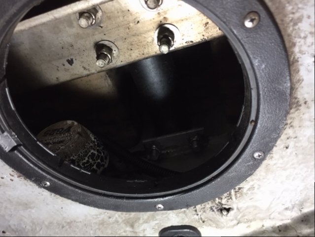

    So, for anyone new to boating that wants to remove their pylon, here are some pics. Very straightforward, however, having a 3/4" deep socket will really save some time. I didn't have one and it took about 10 minutes. First, remove the rear seating to give access to the large floor panel in the middle (where the pylon comes up. The panel will slide up the pylon and come off (3 screws to remove) and you will see the gas tank and v-drive. Next, open the ski locker and remove the access panel to the tank area.
Name:	ski locker.jpg
    That's what should be there. Remove the 6 nuts (I started at the bottom with the wrench to give me room on the upper bolts). Once you get all the nuts off the top 2 u-bolts will be removable by hand. The bottom one is in a groove at the bottom of the pylon but will pull right off after you carefully lift the pylon out, just be careful since the gas tank is right there. Once out, really opens up the interior...
    Now just have to order a Nautique cap or something on a PVC piece and should be good to go.
    Anyway, I know for all of the experts here this is as basic as it gets, but I'm new to this hoping to give someone the courage to do some of this easy stuff if they just need the pics and instructions.
    Being the guy who hopes to get your pylon--keep all the nuts and u-bolts as I gave them away to Hollywood. I covered the hole with a stainless steel tub drain cover. It looks nice to me. You may want something plastic or solid.

    Yep, popped it open and the bolts are there easy as can be. I will work on it tonight and take some pics for future reference for someone else who needs them. Might be a tight squeeze but looks easy. Also looks like there may be a pin at the bottom of the pylon as well. I'll do the bolts first and go from there. 6 bolts.

    Roy, I pulled the floor piece up and see the 2 or 3 bolts in front of the gas tank that hold the pylon in. However, it appears the nuts are accessible from the ski locker in the belly one compartment forward, does that sound right? I ran out of time and didn't want to mess with it last night. I think there is a black circular panel piece in the belly that comes out that should get me access to the nuts on the u-bolts. Hopefully will get to it tonight. Rain was non-stop yesterday.

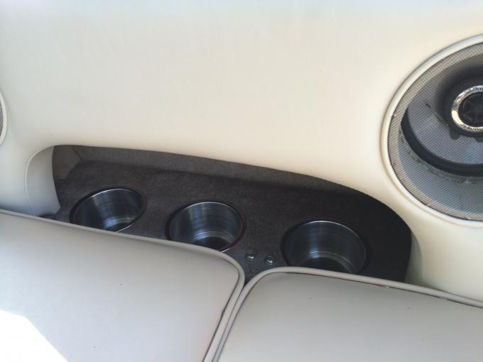

    I paid $33 for 6 of them when I added cupholders to the cubby between the speakers in the main lounge of my boat. That seller doesn't seem to be around any more but below is another example of 5 for $28.50. If you hunt around Ebay a little you might find a better deal. It seems like the more you buy the cheaper they get.
