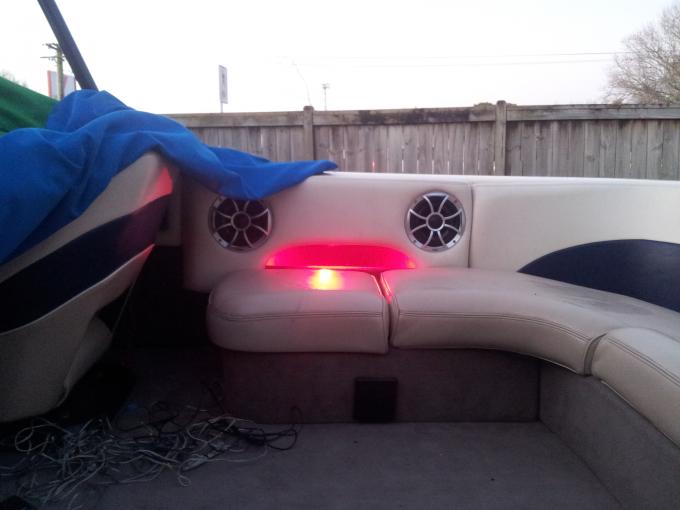

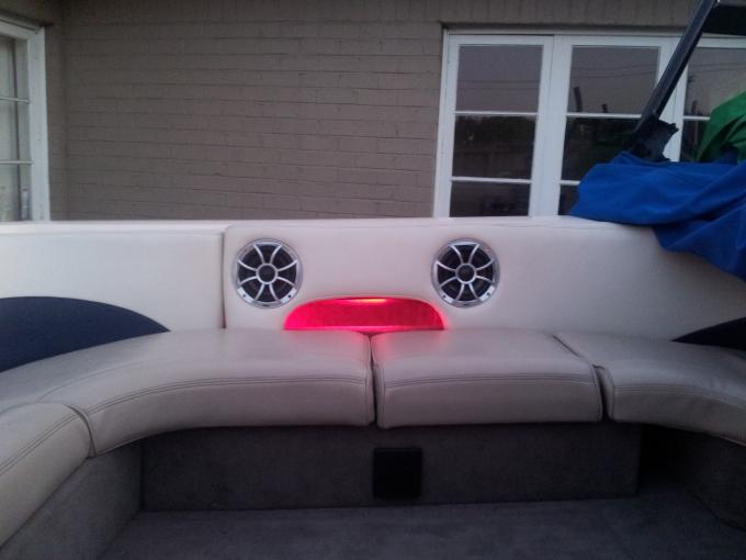

    just got some cheap ones off aliexpress got ten for $12 , i also put them in the s/s cup holders as well looks great
