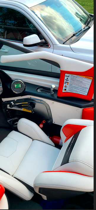

                This is the dash and throttle area on the boat. The top pad on mine doesn't need to be removed as you can get to everything from the bottom. To get to the throttle base you need to remove the top side padded interior trim piece. This uses the typical Christmas tree fasteners. Mine came off pretty easy so I'm thinking someone had been in there before me. I started at the dash and made my way back until the panel was free.

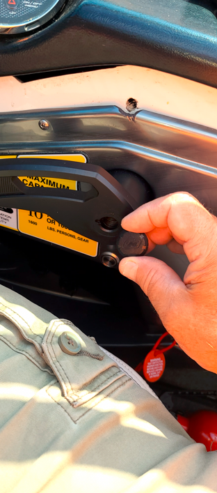

                I wasn't really committed to doing this job until I had the panel off so at this point I decided to remove the throttle lever. This is the same as all the other throttle levers. Pull the cap off and unscrew the retaining hex bolt then pull it off. Mine was held on by a 3/16 hex cap screw.

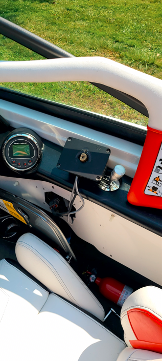

                Getting to and removing the 3 through bolted screws and one wood screw wasn't too difficult but there's just no way to avoid getting fiberglass rash and some minor cuts doing this. This is probably deep down why I didn't want to do this job. At least until latter on.
                Click image for larger version  Name:	image.png Views:	0 Size:	400.1 KB ID:	686085
                Mine was easy to unplug and plug in the new unit. I basically just carefully removed the old one out and plugged the new one in.

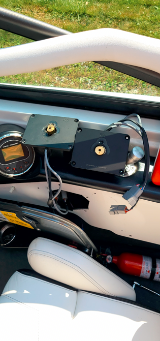

                This however is where the fun began. What I didn't notice as I began to congratulate myself on how smart I was and how easy this was, that if you look closely at the old and new versions they're basically inverted. Yeah, that was going to cause some pain shortly as you have to modify the hole to fit the new version. I had read about this before and there was even a link to the template but I forgot all about this until I had everything apart. Remember that part I said earlier about cottage tools?
                Click image for larger version  Name:	image.png Views:	0 Size:	359.7 KB ID:	686089
                Yup, I own battery powered DeWalt power tools that would have made short work of this like a die grinder, or maybe an oscillating tool or even the good old fashioned Dremel with a barrel bit would have been great but these are not part of the cottage tool package. What is available in the cottage tool kit for this job you ask? A hand file set which the BIL bought recently and I was glad to have. After about 45 minutes of filing and fitting I finally got the throttle based fitted and mounted.
