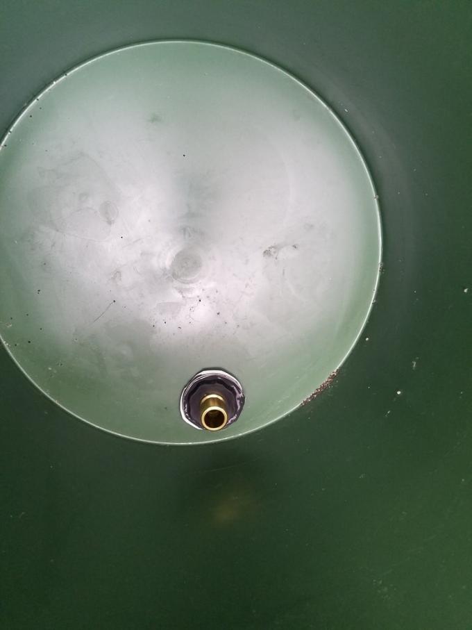

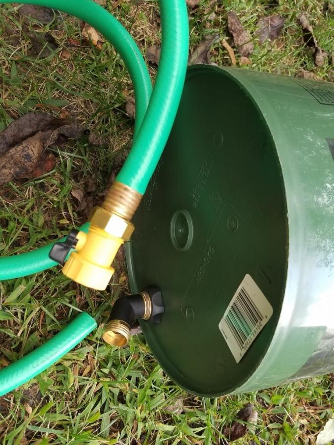

    Here is the 5 gallon bucket I made myself to winterize boat (you can buy something already made similar to this which is where I got the idea but it costs $100).... I bought everything I needed from Wal-Mart except hose for probably $15...the hose I cut off of old piece I had laying at house...cause I could not find anyone that sold hose with both ends on it that was only like 3-5ft long. On inside of the bucket, I made my own "washer" by cutting up some rubber gloves. Basically I pour 5 gallons of AF into the bucket and once ready, I open the valve so the AF can flow while pressing the cut end of hose on the strainer hard so it seals....then I have someone start the engine. 2mins later the bucket is empty and system if full of AF.

      This is great idea thanks for sharing

        Cool fab up infinity, and nice job with the make-shift bulkhead fitting. If you're ever looking to put a threaded connection on the other end of the hose, just grab a hose repair kit from the hardware store - I've had to cut and install new garden hose fittings countless times over the years.
