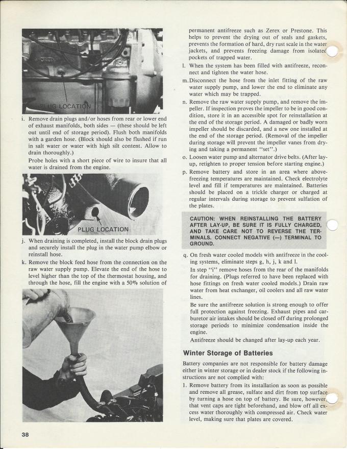

            +1 Tom. I have not owned a Ford powered boat for 17 years but I do know this- It does not matter if the thermostat is open or not and you would know that if you understand how the cooling system works. The thermostat is at the end of the cooling system.Following the picture below you can see the coolant enters into the upper thermostat housing intake,by the blue arrow,this is the port that connects to the raw water pump via a hose.The liquid will then pass through to the bypass of the lower thermostat housing and into the J tube. The J tube connects to the circulating pump where the liquid then enters the block. The liquid circulates through the block and then rises since its also warm and into the heads,where most of the heat is generated. It exits the top of the heads and enters the intake manifold and out through the thermostat housing to be recirculated into and mixed if needed by the thermostat opening with colder coolant. Any excess goes out the upper housing and into the exhausts. One of the advantages of PCM's method is that you can winterize even if you cant run the engine. I have included the winterizing instructions right from a PCM owners manual. As you can see it shows where the drains are at on the first page,(the 3rd picture is of a Chevy) and the second page tells you to drain the block first reinstall the plugs and pour in the antifreeze.
            Click image for larger version  Name:	100_1947-1.jpg Views:	1 Size:	47.0 KB ID:	540376
            Click image for larger version  Name:	PCM winteriziing-1.jpg Views:	1 Size:	113.2 KB ID:	540377
            Click image for larger version  Name:	PCM winterizing-2.jpg Views:	1 Size:	131.2 KB ID:	540378

                          Gary S, thanks foe the pics. The former owner did not have the manual.
                            If you look at the top of this page, you'll see a tab that says Manuals/Brochures. The 93 engine and boat manuals are there.
