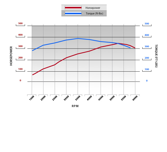

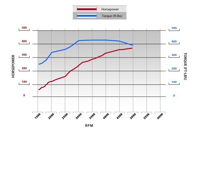

    Just for comparison purposes here are power curve comparisons for the 350HO vs the HT383. I expect the 350HO is very close to the PCM 330 Excalibur.
