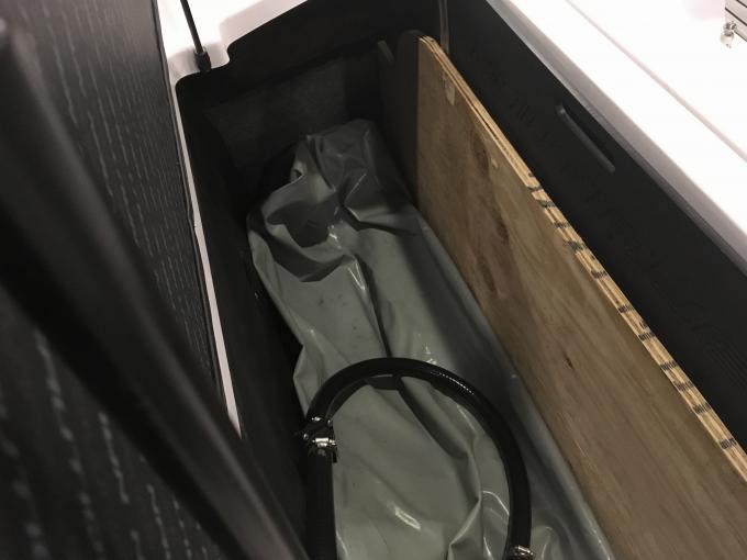

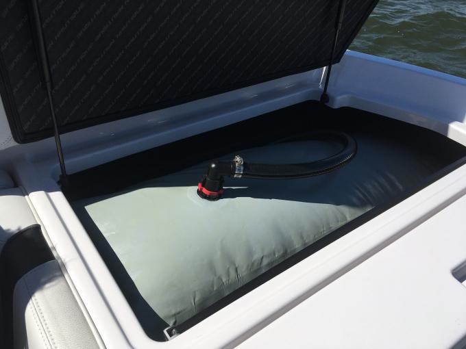

          The 3/4" plywood prevents migration or over bulging of the bag into the engine. I cut a cardboard template to figure out the biggest size I could fit before cutting the plywood. I planned on Rhino-lining it, but then realized I never look at it much so haven't bothered yet.

                            REALLY like the 3/4" plywood idea! I need to add something behind the divider supports in mine to prevent the back of the bag from "slumping" into the flimsy dividers behind the supports.....if that makes sense. Either way, thinks is a very nice/easy solution!!! THX!!!!!

                              Yeah, it's primitive, ugly and needs to be Rhino-lined or something, but it really does work and it was cheap to do.

                                Any chance you have the specs on the pieces of wood? Save us all some time measuring.
