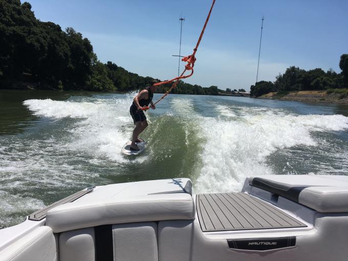

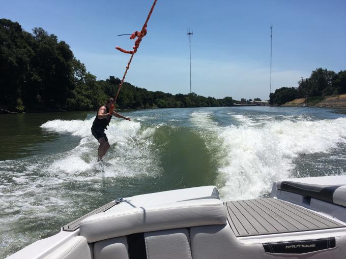

            Here is what you can expect with a properly weighted 2014-2017 230. This is a friend of mine who is 6'-2" and was just learning to wake surf 2 days ago. Click image for larger version

                What speed ? How were u weighted ? NSS ramp ? Vertical plate ?
                • markj
                  • Apr 2005
                  • 1194
                  • NorCal
                  I go slower than most people at around 8.5-9 mph. NSS @ 0. I pull that gate thingy back all the way for more wake height. As for weight, I normally have my stock setup of 400 lbs of leadwake bags and the 3350 lbs of water ballast (custom sacks from wakemakers) that is all controlled from the dash as well as 6-7 people. We only had 3 people in the boat in these 2 pics so I threw a sack in the cabin this time to make up for it and experiment with it. PM me if you want more explicit details or pics of the setup.
