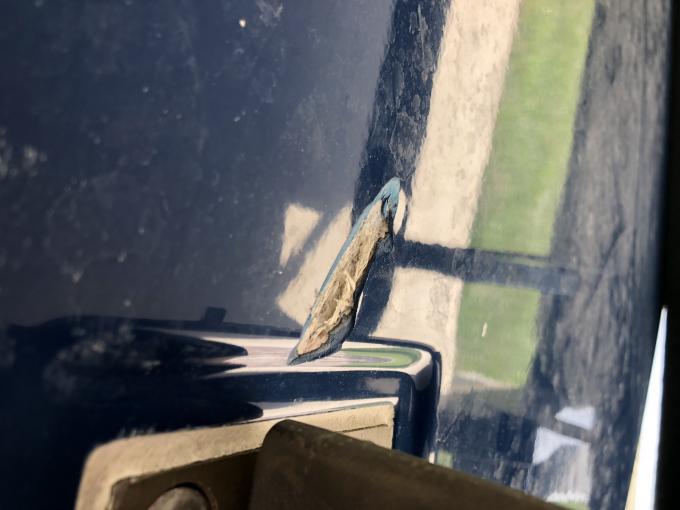

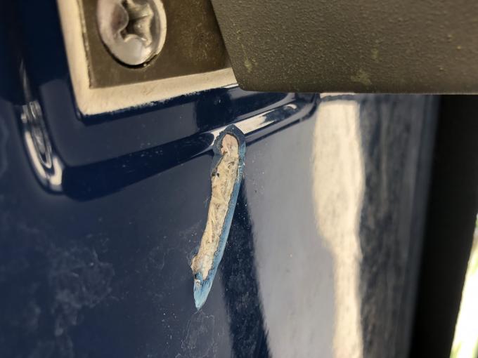

                  #488
                  Broke my prop shaft yesterday afternoon. It also took a big chunk of of the hull too. Pretty much ruined our evening and labor day weekend. I can't believe this is something you have to deal with after spending that kind of money on their "top of the line" boat. I've read the entire thread here and it doesn't seem like they've came up with a solution yet unless I'm missing something. I'd like to know what the percentage of the G's have this happen? I'm assuming it can't be a large amount, but from reading here it seems like plenty. Since it's been happening for basically the entire lifespan of the boat it's really upsetting that they won't fix the issue. Is it the fact that they just don't know how to fix it or they don't want to pay what it costs to do it? Is it that they'd rather spend their money on marketing and driving up the cost of the new models rather than R&D to take care of a major problem that has costed countless Nautique owners both time and money from having to tow the boat in and haul it to the dealer? Am I supposed to cringe every time I engage the throttle from now on for the rest of the time I own this boat wondering if this will be the time I'll be stranded again? This is absolutely absurd to me!! I can't believe Nautique would just sit back and continue to let this happen.

                        #491
                        Here are the pics from when mine broke

                          #492
                          Looks like it propagated from that keyway... sucks.
