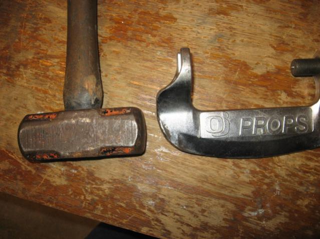

                        In 30 years of either working in the R&D dept At CC or in my own current busines I have only had to heat a prop hub one time and it was on a salt water boat.
                        When you load the puller with the prop retainer nut almost to the end of the threds and not falling off, reach under the boat with a heavy ball peen hammer and strike the back side of the puller on thick part of the puller that is facing towards the bow of the boat, it is designed to take a blow.Click image for larger version
