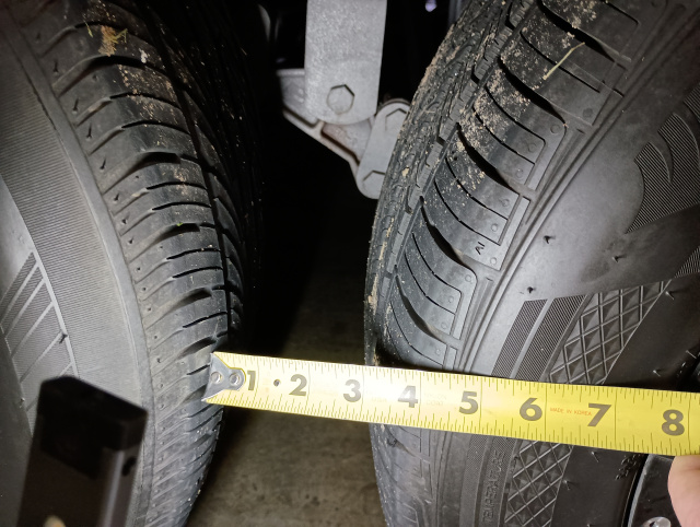

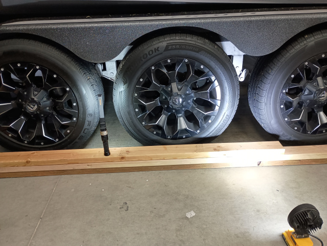

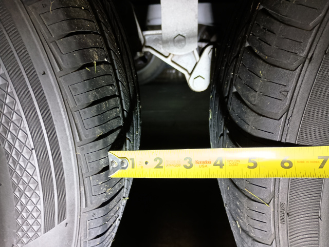

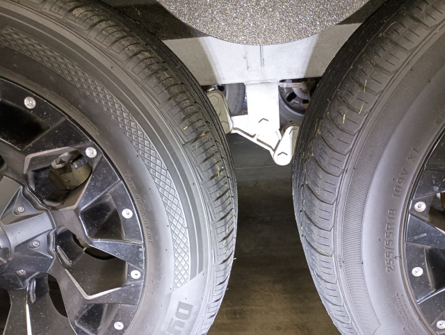

                    Took a closer look. My cause for concern here is the spacing between the tires, I would think they would be close to equal, have about an inch difference on each side. As long as the wheels are rolling straight maybe that's ok. We took a few long distant trips this Summer, along with 40 or so hops to our local lakes, and not seeing any abnormal tire wear. I think I'll bump the pictures over to Boatmate and a local spring shop, see what there take is. The only think I can come up with is spring sag, but on a 3 year old trailer seems odd.

                      Update:
                      Scott from Boatmate got right back to me on the phone from an email inquiry. He said they lock those equalizers down (tighten) for shipping purposes, and they also go through the paint rack after they are locked down. They put red tags on the equalizers, and it is up to the Dealer to loosen the bolts prior to delivery on both the springs and equalizers. Loosen, tighten, back off one half turn. He said he's seen trailers go for years still tightened down but will eventually start to cause tire wear issues.
                      Scott also indicated that they have been severely short staffed for many moons, and they are ramped up and rolling now, for what it's worth. I've never had a problem with Boatmate, and they have always been great with whatever I've needed addressed over the last 20 years (since our 1st Boatmate Trailer). I know others have not had the same experience, sorry to hear. I also reached out to a local Spring Shop, he threw some spaghetti at the wall, but did also mention to check the tightness of the bolts to make sure they were not binding.
                      I'll give the loosen method a run and see what prevails.
