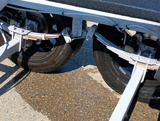

        Thanks again Scooter G! Anyone else notice their trailer suspension is set up like this?

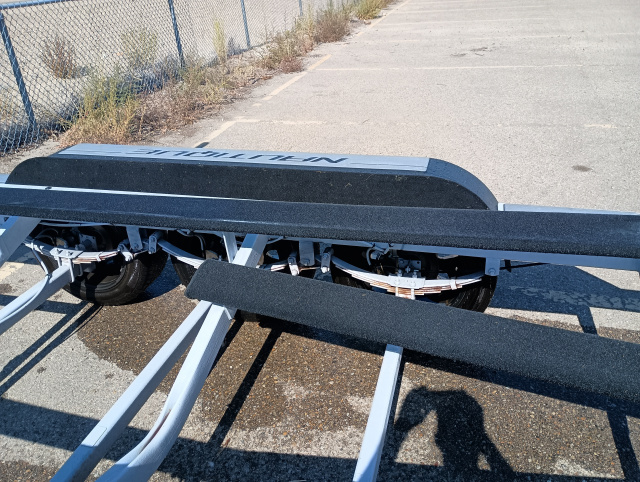

            Not sure what to think here, doesn't seem quite right. Bolts were not overly tight, the only ones that I would consider snug were the center bolts on the equalizers. I got them all even, snug, and then backed off one half turn as suggested by Boatmate. Also hit them with some spray lubricant. Nothing really changed, different day same stuff.

              For grins, I'd jack that entire side of the trailer up and let the suspension hang loose. And then set it back down and see if it normalized. It's even possible you need to get both sides of the trailer of the ground as it's a connected system. But maybe you did this in the process of adjusting the torque?

                  FWIW, a simpler solution may be to just tow for a few miles. That may be enough for it to normalize. Not sure why I didn't think of this last night. If it doesn't clear out with the boat on it, I might also try with the boat off.
