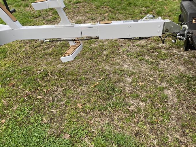

    Does anyone with a 2021 Boatmate trailer for a G23 have exceptionally short safety cables? I have an f150 with a pretty standard length hitch and the cables WILL NOT reach the connection points. I trailered the boat home from the dealer with a 3500 HD and the cables wouldn't reach to the safety attachments on that rig either. (clearly the attached image is showing the "unsafe" way I connected the safety cables for the 2 mile drive to the launch. Anyone else have this issue? Worth bringing up to Boatmate?

    On our trailer that's not an issue, but I'm using a Sierra 1500... still have plenty of cable. I wouldn't accept that in your shoes though, should be easy enough for them to fix I'd think... but I'd make them fix it.

      Clibka....my G23 arrived at the dealer a couple of days ago. I went yesterday to look at it for the first time...and sure enough....it appears the cables are WAY too short on my Boatmate. They "Might" reach...barely....but will I be able to even turn the trailer without the outside cable stretching to the max point?? I've got an F250. I won't pick the boat up until later this week....so I might have to rig some type of extensions. I did mention it to my salesman to relay to the shop manager. I honestly stood there shaking my head when I saw how Boatmate set that up. CLEARLY....the end mount point where the cable is attached to the tongue could have been moved up about 8 inches to give more length. And....it appears to have nothing to do with it being a folding tongue. Oh well...it's always the people that make em' that don't use em'........

        Boatmate will send longer ones for free. You need to tell your dealer and they will order them.

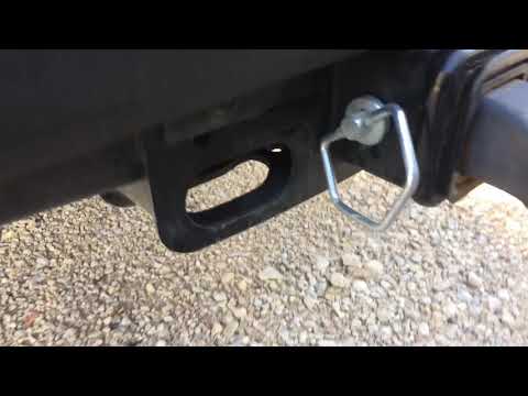

                  Also....another irritating issue with the Boatmate cables....the "style" of hook they use OF COURSE has changed since my 2015 Boatmate and the hooks will not fit through the oval holes on the Ford receiver hitch (which is a know issue on the Ford hitch). I blame both Ford and Boatmate for this. Ford F'd up on the shape of the holes....and Boatmate used Too big of a hook/clamp combo to work....aside from them being TOO short. Oh well....luckily I don't tow every day...just a PITA to pay that much for a trailer and it has to be modified before I even use it.

                    Clibka...instead of ordering longer cables, my shop manager repositioned the cables closer to gain the slack. He drilled through the bottom rung of the ladder just above the tan SeaDeck in your picture. Put one long bolt all way through the hollow step and tightened them down. Gave me all the length I needed without new cables. Just an Idea if you want to try it. Ken
                      I've never had a problem. You might want to try hooking them up this way.

                        Thanks....but...yeah....no go on that Video. Did not work. And if you do happen to get them on...they are a BEE itch to get off. I'll probably go with some carabiner's clips.
                              Smindustries.....I stand corrected. I tried the hooks again like the video shows....had to adjust to the right angle....BUT...they did work. I just remember trying it with the utility trailer big hooks and couldn't get them to fit. The new Boatmate hooks will work as long as you do exactly as the video shows. Thanks for sharing!! No Carabiner clips for now.
