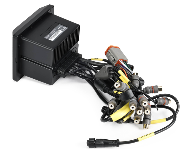

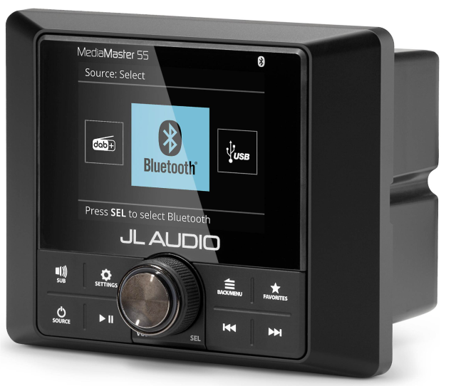

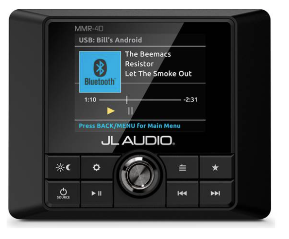

      I struggled with this as well and have gone through the "bench installation process" a bunch with my boat back in the Covid days when we were using the boat a lot. I'm not familiar with your dash so I don't know the space limitations but its probably pretty safe to assume that your dash like mine is full of irregular shaped openings in hard to modify gracefully, vacuum formed plastic that were made for a very specific gauge package layout. The days of flat, rectangular panels are long gone.
      With mine, I was leaning towards the JL remote in the dash and sticking to the Clarion hidden amp concept which is currently installed but just upgraded to the JL system. My beef with the Clarion is the single line liquid quartz display which is near useless unless you're looking directly at it while the boat is stationary. The problem here, like yours is will it fit (most likely not without some scary modification) and then there's cost. The remote alone is $300, the hidden source unit is another $350. All in with tax and shipping you're talking $700 for what would be a functional replacement. That's a lot of cash for the visual improvement, which is why that got put on hold. At that price I'm leaning more toward fixing the neutral lock out which is a whole other thread/project.
      Like you I could delete the source unit from the equation as there is little value of having it in this small boat and do the Media Master 55 directly in the dash for much more palatable $400 but like you (again) the thought of wrangling the wiring around the bow or under the floor strikes dread in me while I have a working rig.
      In the end with my situation and at this point in bench installations, I'm leaning towards the dash installation. The KISS theorem (Keep It Simple Stupid) keeps blaring in my mind with the 2 stage installation. Twice as much hardware and wiring to break and little to no functional gain. The part that keeps me from going this direction is the last picture below which illustrates the wiring mess you would be dealing with. Figuring out what to do with that mess behind the dash would be challenging and unless I did it properly it would drive me nuts even though it wouldn't be visible.
      So, to sum everything up, I feel your pain and unfortunately have done absolutely nothing to help you other than to rehash the same concerns you have. At the end of the day If I were to take on this project, even though I don't see the value (which is why I've done nothing), I would probably spend the money and do the remote source box so I could sleep at night. Which in your situation would be to buy another head unit and hopefully find a remote you can live with and will somehow fit.

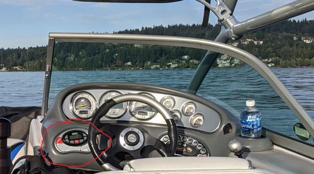

            Here's a snip from a shot I had that shows the dash. The problematic remote is circled.

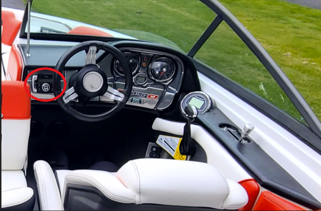

              I think going to the round remote panel and remote is about your best/only option. I was out surfing my boat this morning and looking at mine again. Yeah, it work's fine so I'll leave that alone and watch your progress..
              Did some more scouting on the throttle base while there and if the replacement depth sounder transducer fixes that problem I think I've talked myself into replacing the throttle base and keeping the boat. I moved the boat to a friend's house on a private lake that has a 3 mile surf run that averages 60' deep. Last year I put less than 10 hours on the boat. I got the boat moved over 2 weeks ago and have 7 hours on the boat now. I'll keep it listed until I go on vacation in 2 weeks. If no sale I'll keep it and remove the listings. You guys may be stuck with me for a few more seasons.
