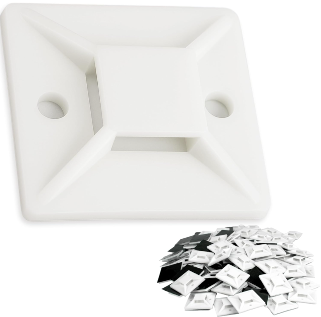

              When I added my amp on my 200V Sport I used some 5200 to stick some tie wrap mounts to the inner underside of the bow rider seating base then ran the cable from the existing breaker along the path I created with the tie wrap mounts. They've been up there for 5 seasons now so that worked. Not pretty or the way I had hoped to run the cables but it worked. Using the inner path probably saved me a good 3' of cable and probably 6' when you consider I needed power and ground cables for the amp power.

                Whoa. Seated them in 5200. You don't mess around. Thanks for the suggestion bturner...those clips are a great idea.

                  They kept falling off from the weight of the power cables and the 5200 is what I had laying around at the time. I'm sure some constructions adhesive that dries fast would work just as well. One you have them in place you can reuse them should you need to replace the cables or add to them. Cut the tie wrap, remove the old one and reuse the base.
                  They make those in different sizes for the widths of various tie wraps. Home Depot sells them by the bag in the electrical department and you can actually see the size you're buying.
