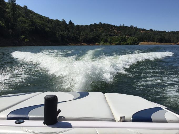

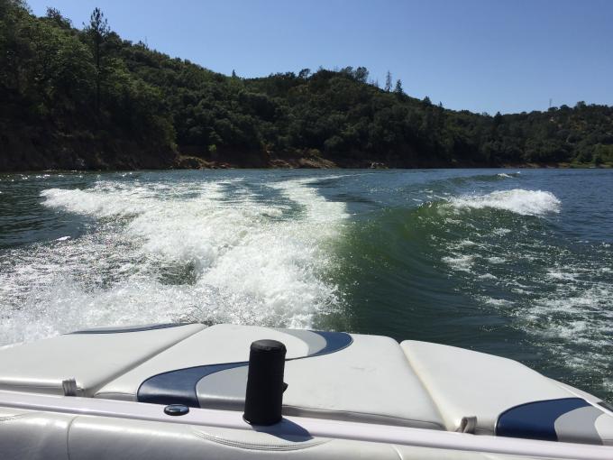

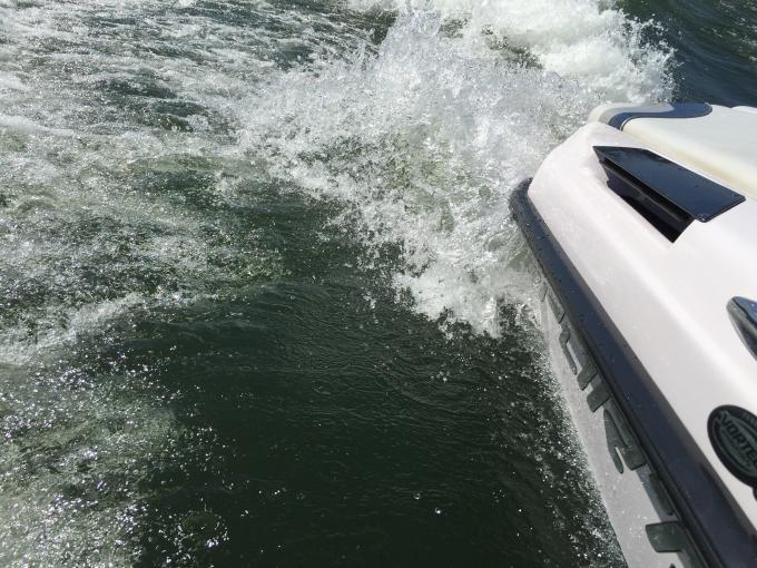

    Here are my before and after pics from my wakegate. For reference 03' SAN with 250lb tanks in rear both full and belly full, 400lbs of evenly distributed lead. two people in boat, 10.5 mph. And then a pic of the wakegate on the starboard side.
