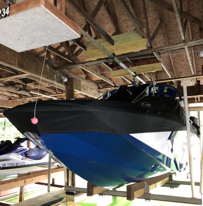

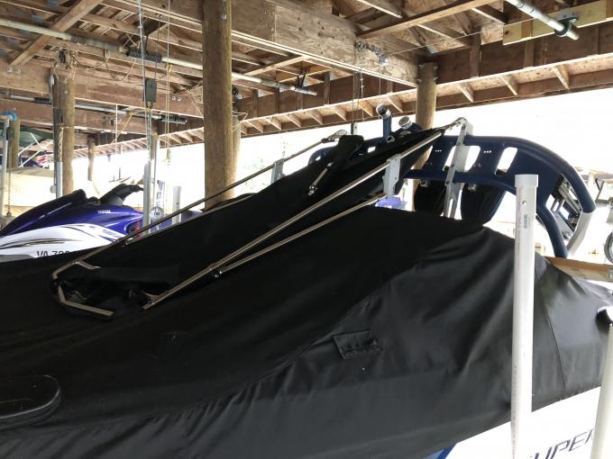

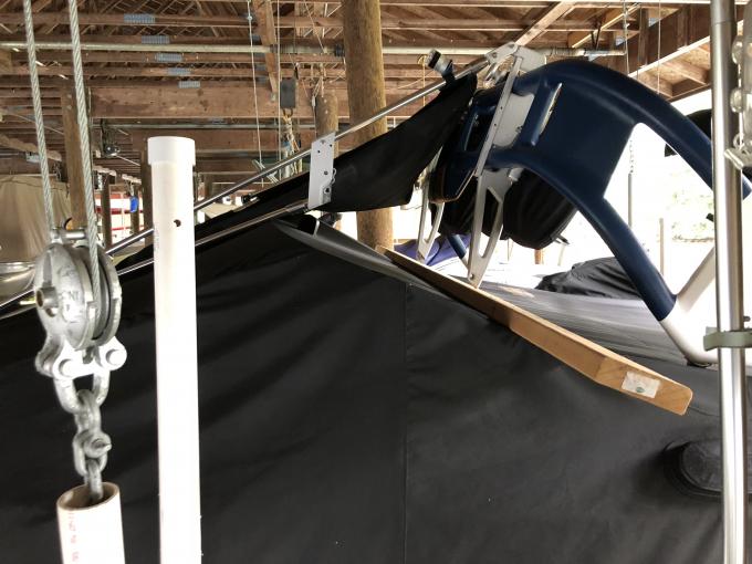

        If anyone has a stock bimini top in recent years prior to 2019 and wants to raise their boat higher in their boat lift with the tower down, bimini folded forward towards bow with boat cover on the boat here are some pictures of my method. I was able to raise the boat another foot or so in my lift as the eastcoast storm approaches. If anyone wants to try this method when you purchase the 2 x 8 lumber plank make sure you get the un-treated lumber so it is not so heavy; the bimini frame simply lays down on the wooden plank.
        This took me about 30 minutes to complete alone today. I like the fact that I can get the boat another foot out of the water with tower down and full cover still on the boat.

            Can the bimini flop up and down, particularly if the wind comes from the front? I think it can, which may be a problem.
            • cedarcreek216
              • Oct 2009
              • 1009
              • Dallas, TX
              • 2018 210 2013 210 2009 216V
              May just want to run a ratchet strap around the Bimini and boat to keep the Bimini from blowing up from the wind. Or just find some way to secure it down.
                  Yes I think so since Bimini has 2 gas extension arms

                      Just a thought, if your cradle has a snug fit in the boat slip, I would raise it to where the cradle itself is even with the slip facia boards. I weathered a few hurricanes this way after I saw how much my boat swayed in high winds. Just a thought.
                      • GMLIII
                        • May 2013
                        • 2821
                        The last picture is in the full height position , any higher it would crush my tower all-round light. I may eat my words here but as far as my location is concerned, I’’m pretty far inland and I’’m more concerned with rising water levels as opposed to high winds. This covered dock area comprises of about 28 boats so it is rather large and protected
