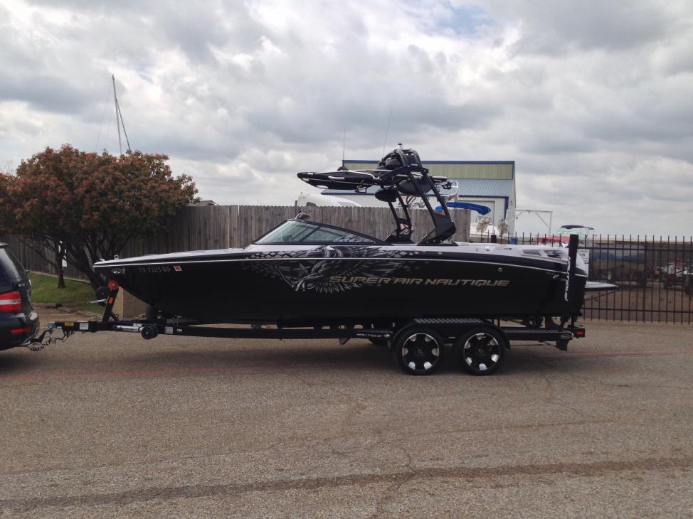

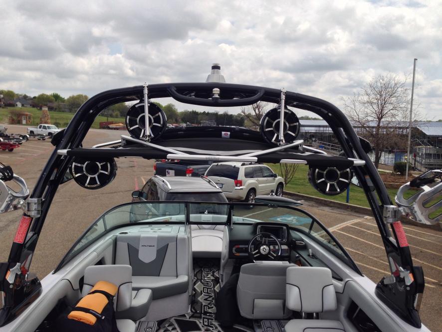

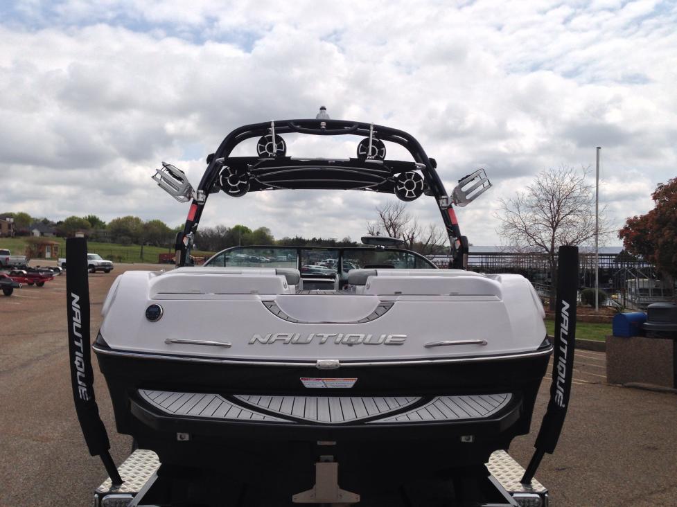

                    I finally got the boat back today. Got some pics for you. Z5 with 4 REV10s and Z5 in stock position (not lowered).

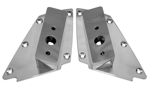

                      Axeman - WOW, that is a good looking 230.....love the all black. Okay, awesome - looks like it is possible.....this looks like a really nice install. Quick questions: 1.) Do the two upper REV10s touch/hit the Z-5 going down the lake? My worry is that the speakers will wear out the Z-5 canvas if there is friction between the two. 2.) How do you have the top REV10s mounted to the tower? I can't tell if you used the "around the bar" clamps that come with the REV10s or if you somehow used the existing mounts that were used with the OEM Roswell tower speakers. Also, for the side speakers, did you use the following mounts from EarMark (see pic below)?

                        Let me try the pic again.....

                          The top speakers do not touch the Z5 at all. I didn't take close-up pics but I can get those this weekend if you would like. I used the "around the bar" tower clamps that come with the REV10s. You cannot install them in the stock Roswell speaker location without lowering the Z5. Yes, I used those mounts for the side speakers. One thing I noticed yesterday while out on the water is that the tilt movement of the Z5 is limited by the lower REV10s. So if this is of major concern to you (meaning you want to be able to tilt the Z5 completely perpendicular to the boat) then I would suggest going with a pair of REV8s for the lower speakers. I'd say I was able to tilt it between 30-45 degrees which is plenty for me.

                            Axeman - okay, got it. Great to hear that the upper speakers to not touch the Z-5 at all - do you have the upper REV10s mounted to the first bar on the tower (bar that is closest to the bow of the boat)? in an effort to keep the speakers more "in-line" with the bottom two speakers that are mounted on the side brackets, putting the upper speakers on the first bar would make sense. When you say "tilt movement", does this refer to the movement of the Z-5 when you disconnect two of the pins and are trying to swing it? For me, this would not be an issue because I plan to just take the Z-5 all the way off the tower when I go to store it back in the garage.

                              Yes, the top speakers are mounted onto the first bar on the tower (closest to the bow). I would imagine they wouldn't fit on the second bar since that is where the Z-5 attaches to the tower. Yes, that is what I mean by tilt movement. Normally, people tilt/swing it to put boards up there. By the way, I'm glad I got the Z-5. It provides so much more coverage than the standard bimini top!
