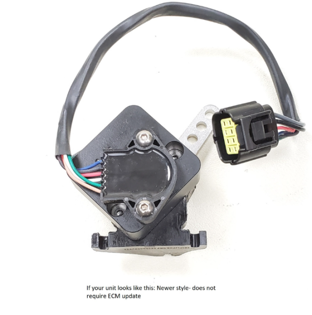

              This is what I replaced. The base was broken

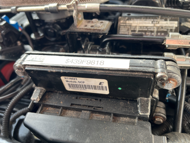

                      I still don't know if you have the eControls or MEFI ECU. Can post a photograph of the actual ECU on your engine. Make sure it shows any labels that are on the ECU.

                            None of that can answer the question. During 2007 some excalibur 330's where assembled with MEFI ECUs and some with eControls. The only way to know definitively is to see the ECU on the actual engine in question. If it's an eControls, then I think it's likely having it flashed will solve your problem.

                              jpwhit,
                              Thanks for the help. I've attached a picture of the module. The boat ran great all weekend. Started up great, sounded great, good oil pressure, prefect engine temp but the check engine light is still on. Do you think the module stills needs to be re-flashed?
