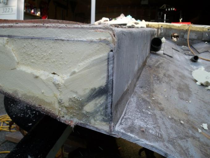

                              I think I be very careful using pictures of a boat that has nothing in common with mine other than the name before randomly drilling holes Here is a picture of a composite boat around your vintage. Looking from front around the dash area along side the starboard side showing double floor,foam and aluminum reinforcing plate
