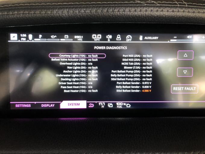

            After further research , I have found that my ballast pressure sensor is bad and not the impeller. I'm guessing your ballast that alway says 100% full actually is complete empty 100% of the time.like my boat. Go under your System Diagnosis page on your LINC screen then to Power Diagnosis and look at the last several line items. From my screen picture , you can see my problem plain and clear. This has become a common problem for many of the late model Nautiques. Eventhough my boat was winterized, I beleive the issue occurred over the winter when the ballast pressure sensor corroded.
            Click image for larger version  Name:	IMG_1139.jpg Views:	0 Size:	48.8 KB ID:	584445

              Yep, mine showed high as well, then went back to normal. I check it regularly, and it’s completely variable..

                Sounds like yours is getting ready to malfunction completely. Mine is high voltage all the time so I know mine is toast
