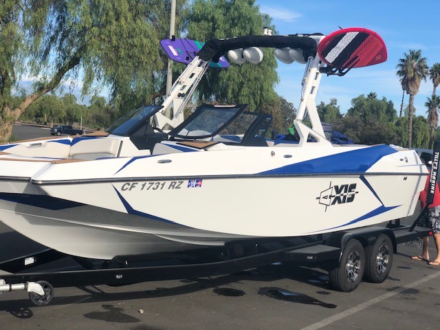

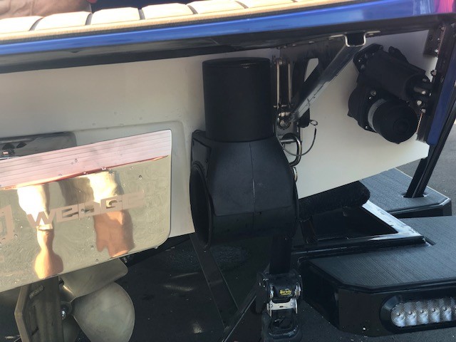

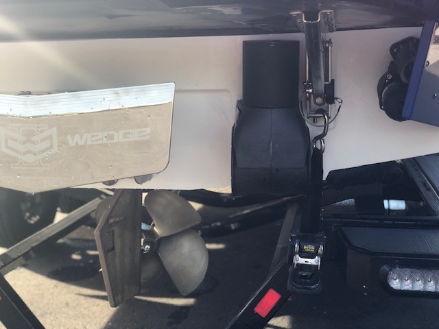

                Sorry been busy with other systems and shows, 2019 will be big for Easydrive with some big names. Check out the recent Axis installation photos. Nautique at White Lake deal was put on hold.

                    Have not had a large loss in performance due to cavitation, again we use the cowlings to help prevent this as well.
                      In the boat you posted it does not have a surf pipe exhaust like most of the modern Nautiques in which it is a standard feature now days. Have there been any tests on after market stern thrusters on a Nautique with a surf pipe exhaust system?

                            Yes Nautique stern thruster options are internal thrusters, with motor mounted inside boat. We created the external option which equate to no need for an exhaust, water cooled units, much quieter, and run times of over 10 mins.

                              Cavitation. The intake (much like an impeller on a jet ski) pulls water at significant rate. The surf pipe exit location is a problem, as it allows the "pump" to pull agitated water from the bubbling pipe, which will cause cavitation.
