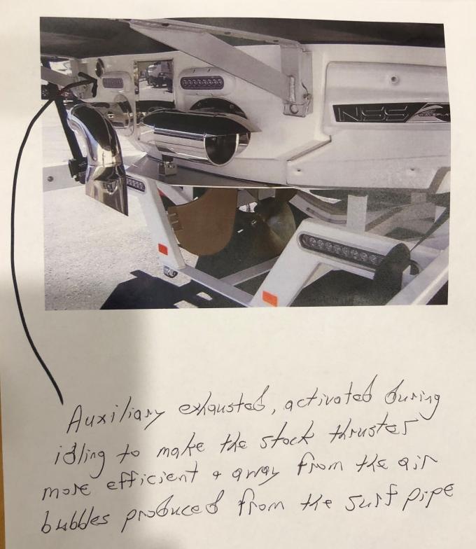

                Click image for larger version  Name:	thruster.jpg Views:	1 Size:	62.3 KB ID:	559752
                Brian on the demo Yacht Thrusters which are being installed on the White Lake Marine Nautiques, how are they dealing with the loss in efficiences produced from the thrusters by the air bubbles generated by the surf pipe? I have attached a visual of the stock thrusters showing the auxiliary exhausted used during idle. Obviously any potential purchaser of a Yacht Thrusters , who has a Nautique would not want to install an auxiliary exhaust to make the thruster more efficient.
                  The amount of power our thrusters offer (77lbs of thruster) will have limited effect to the air bubbles produced by the surf pipe. We do offer optional cowlings that fit onto our thrusters and allow user to direct the water flow, which will enhance performance around anything mounted on the stern, air bubbles, plates, etc.
                    Looking forward to the review from the demo White Lake Nautiques once complete
